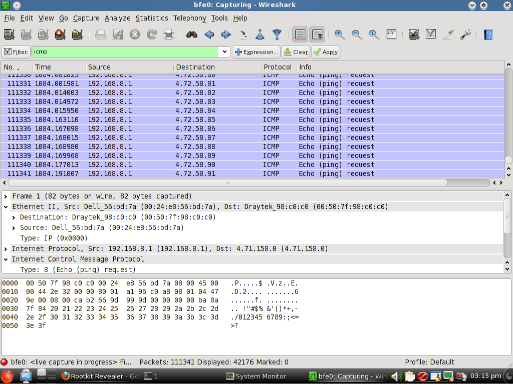

Wireshark is showing I have about 12 icmp requests being sent every second from one of my servers (win 2008 64bit SBS FE)
The src ip is the lan card in the server, the destination ip keeps incrementing by 1 each scan.
I've tried tcpview, but that doesn't seem to show icmp?
I've tried MS Netmon 3.3, that shows the traffic, but 'unknown' process
Full malware bytes scan is clean
Panada Corporate Scan is clean
Kaspersky AVZ4 (script 2 comes back clean)
I'm thinking either the src ip is spoofed?  or i have a rootkit hiding somewhere
Any one got ideas how to find out which process is generating this traffic?

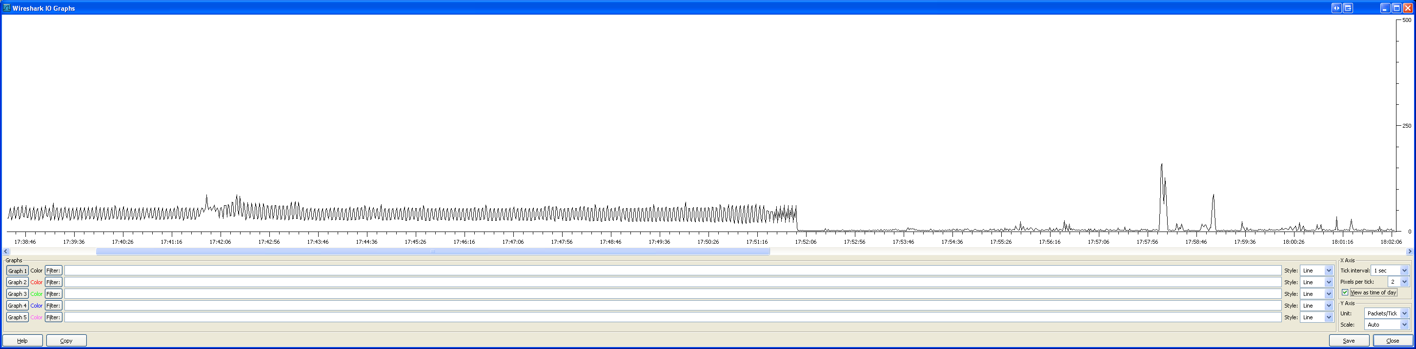

by: pc-cytPosted on 2009-11-09 at 08:07:38ID: 25777129
For those interested, here is a screenshot showing the bandwidth usage.  Crazy!
You can see I rebooted the server around 17:52.  The bad ICMP data disappeared.  I think i cam,e back sometime after 7pm.  I need to go back to site and find out for sure.
I'm still looking for a way to show which process is generating this ICMP traffic - Any more ideas?

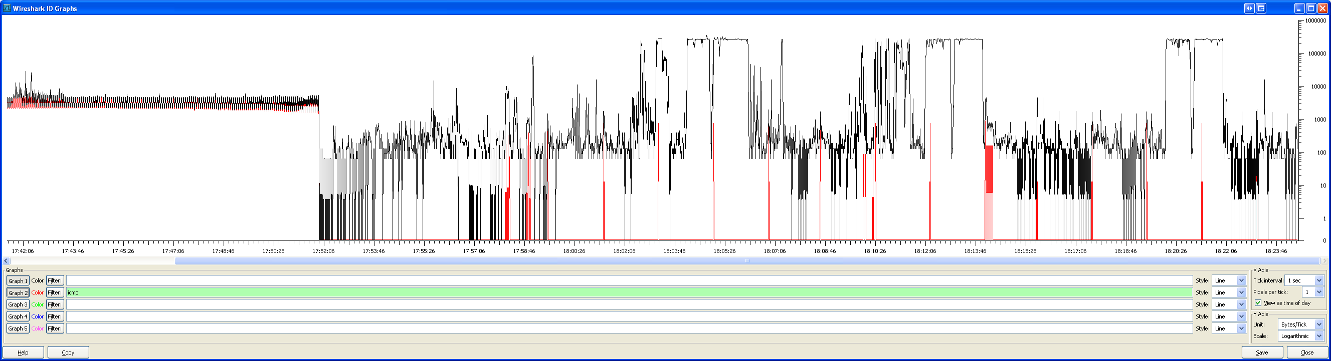

by: pc-cytPosted on 2009-11-09 at 08:09:51ID: 25777157
Here is another IO Graph.   You can clearly see when the server got rebooted!
