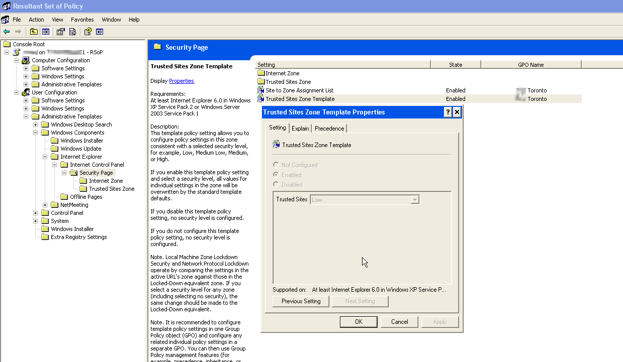

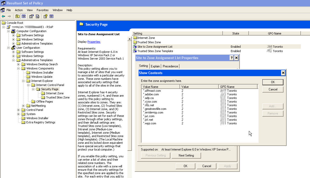

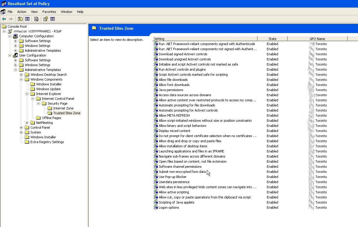

by: nappy_dPosted on 2009-02-06 at 10:26:28ID: 23572532
What GPOs did you apply?  Do the setings look like this?
