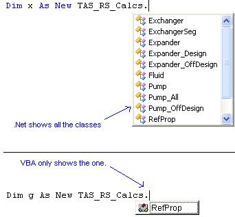

I'm writing COM compatible .Net DLL. In other words I'm writing a .Net DLL that, and I need it compatible with VBA so I have already set "Make Assembly COM-Visible"=True and checked "Register for COM interop". When I compile the Project it generates the tlb file and I'm able to reference the tlb from VBA. But once I go to instantiate a class I find a problem. Only one of the many public classes is availible.
My assembly is called TAS_RS_Calcs and I have several public classes including RefProp, Fluid, StreamPath, etc. So I should be able to see Fluid, for example, under TAS_RS_Calcs, but all I get in the intelliscense is RefProp.
Dim g As New TAS_RS_Calcs.Fluid fails from VBA, but Dim g As New TAS_RS_Calcs.RefProp works.
While Dim g As New TAS_RS_Calcs.Fluid works fine in .Net
So it seems that in the translation from COM to CLR there is a problem or vise-versa. This DLL was fully functional before I don't know what I could have done to cause this.

Can someone please tell me why only one class is accessible via the tlb COM reference?

<System.Runtime.InteropServices.ClassInterface(System.Runtime.InteropServices.ClassInterfaceType.None), ComVisible(True), Guid("27E16904-00A2-4be1-AFC7-2C14D2623DD9")> _
Public Class Fluid
Am I missing something? It's been known to happen. I'll go ahead and add these arguments back, just in case.
I thought the old class definition was somehow "stuck" with the GUID. I understood that changing the GUID was key. i also found that unregistering the tlb was effective in removing all references to the tlb, dll, and the associated GUID from the registry.

Pretty much, except, that VBA will only see Refprop and those test classes I added last.
Did your interoptestlib.dll assembly have Refprop and my other classes in it or was it a fresh new assembly???
if so, I guess maybe the regasm and TLBExp are tripping on one of my classes then failing to build the interface structure for the others.

Ok, I think I figured it out.
You had the "make com visible" option enabled on the "assembly properties" dialog, off the main application properties tab.
As soon as I turned that off I could see the classes that I explicitly made visible, including "Fluid".

Something I noticed, though, was that even those these classes wouldn't appear in intellisense as Types, they DID appear in the object browser as classes. I'll bet it's something simple.
by: benblancoPosted on 2009-10-12 at 12:17:51ID: 31636025
Boy, do I feel dumb!? You were right about the class needing a parameterless constructor. that was it. I kind of blew that off because I thought that applied to another type of interop.
"...COM must have a parameterless constructor"
Didn't need the GUID's. Here is what worked
