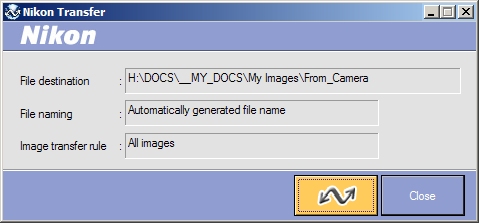

Although it states that it only works with Nikon cameras, I'm not convinced.  I've just connected my cheapo Vivitar digital camera and it launched the Nikon Transfer "dialog" as intended, and copied all images correctly using the settings I entered.  I am hoping that this standalone and updated version of the program will work just as well.
The reason I am proposing this as a program for your purposes is that the selected "Destination Directory" is stored in the registry along with other settings such as the naming conventions, etc.  Once set, it is easy enough to hide the option buttons from the user with a quick modification of the program executable's resources, and just leave a bright yellow "Transfer" button for the users to click.

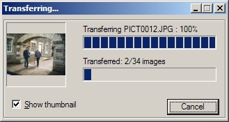

Kind of idiot proof really, connect camera, up pops the little dalog (See screenshot 1), click the transfer button.  It optionally displays the thumbnails of images being transferred to convince the user that it is working (See screenshot 2).
