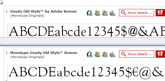

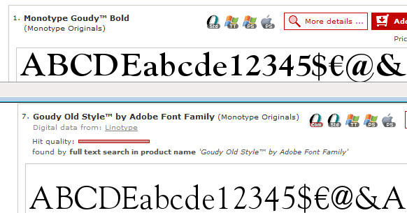

by: aleghartPosted on 2009-10-06 at 15:46:29ID: 25510714
Important to make sure that we're talking about the same flavor.  The name "Goudy" is used for many different versions of the same font, or different fonts designed by Frederic Goudy.
For instance, see "Monotype Goudy" from Monotype and "Goudy Old Style" from Adobe.  Both are called "Goudy" by designers, but are visually quite different fonts.
by: aleghartPosted on 2009-10-06 at 15:53:35ID: 25510755
Here are two sample of Goudy Old Style.  See the difference in the capital B and the lowercase d & e?  Proportions are different.  Even with similar x-heights, the bowl shape in the lower sample is wider, meaning that the same type will set wider or longer.
