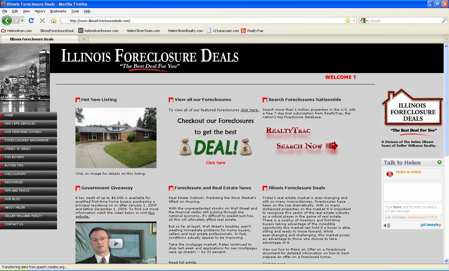

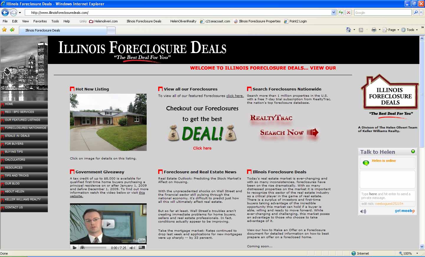

I have website that I have created using a template based online program for a real estate company. The program lets me do some custom content. I have created the The menu buttons and left side custom.
The problem im having is the menu aligns to the picture above it fine in IE, but in Firefox its stick out to the right a little bit past the picture.

can you post screenshotof the menu sticking out?  In both IE8 and FF3 the menu buttons both stick out to right past the image above it by at least an inch.

Im using IE7 so could be the reason its working for me.
