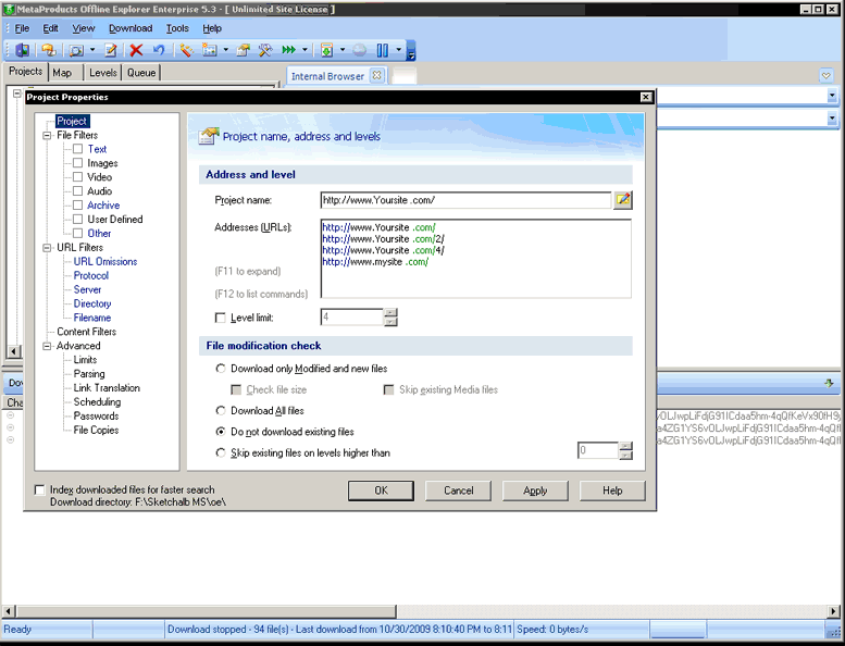

by: selvolPosted on 2009-10-30 at 20:24:18ID: 25708222
That software is a downloader indeed. But that is just  part of it.  It will extract the URL's.    Just make a project and add the starting URL of the site and any more start points.  In properties Uncheck all the boxes such as text etc.. Check with in the same server and leave the depth unchecked.     Scan the site. When done goto to (top Menu; Create site map)  It will spit out a text file with all the URL of that site. And nothing is Downloaded but the sites structure.
See attached image for a visual explanation.
I am not trying to push the software. As I get nothing out of it. I am not sure what your needs are but I can tell you from experience with this software. It is top notch and worth the $500 price tag.
But as I said 30 day unrestricted no Adware no spyware. ANd a great software company behind it.
Try it you can . If not I hope you find the right software .
