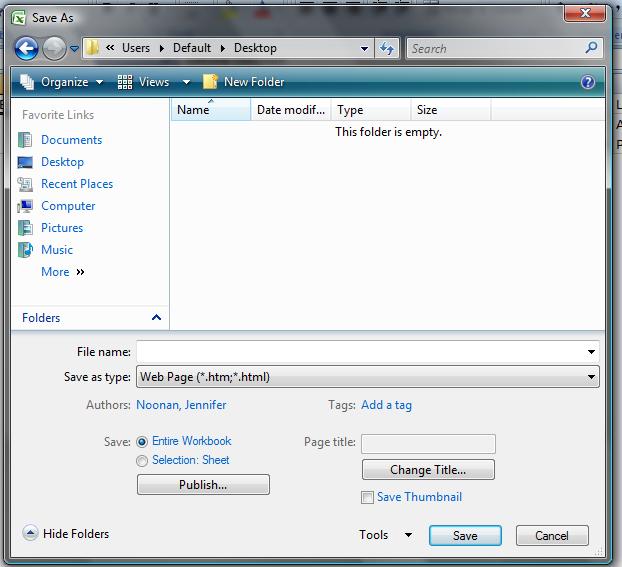

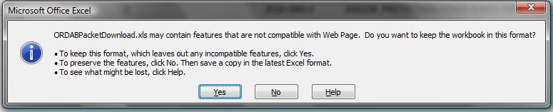

I save the file to my desktop, open the file in Excel, make a change and click the save button; then I receive the following pop-up message (untitled1.jpg).
If I click the No button, the Save As box displays (untitled2.jpg) but the Save as Type box displays as Web Page (*.htm, *.html); is there anyway to download a "true" Excel file that doesn't require the Save As process?

Have you tried opening the same file in different browsers and everytime you download get the same error!
Please check and then let notify here
by: calibreincPosted on 2009-11-05 at 18:38:40ID: 25756215
I only have IE installed on my system but yes, everytime I download or open and then try and save, the save as type defaults to web page.
by: myselfrandhawaPosted on 2009-11-06 at 05:59:59ID: 25759103
by: calibreincPosted on 2009-11-09 at 07:43:35ID: 25776867
I'm using IE version 7 and this issue and resolution applies to IE 5.5; wouldn't IE 7 already have this fix and not require a v5.5 update?
by: myselfrandhawaPosted on 2009-11-09 at 19:02:23ID: 25782038
Chcking your screencasts. It shows when you try to save it it asks yo thet some parts of this excel file is not compatible.
If you go and save it as XLS and then again open in XLS it will work.
Please correct me if i going in wrong direction
by: calibreincPosted on 2009-11-10 at 11:22:22ID: 25788753
That is correct, however I don't want to have to do a Save As or see the non-compatible pop-up messages. I need to download the file as a true Excel document, not a "web page" or XML doc. If I download the file, make changes and click the Save button, it should save as Excel and not give me the pop-up box above.
by: _agx_Posted on 2010-01-31 at 07:42:12ID: 26448924
  Yes, generate a _real_ excel file.
  http://www.google.com/#q=poiutility.cfc&oq=POIUtility
  What you're generating is just HTML. That's why you get the warning. There's no fool-proof way around
  this other than to generate a _real_  Excel file which is a lot more complicated. Another possibility is to
  generate a plain .csv file.
