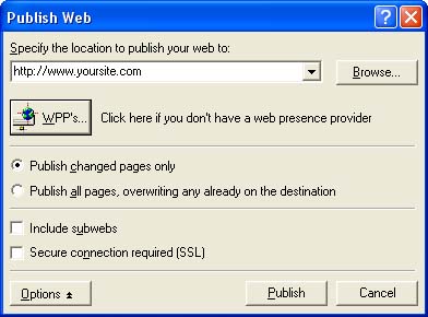

by: mekhet30Posted on 2008-11-25 at 04:40:08ID: 23034003
You need to use the Publish function in FP
File -> Publish Web
Enter the necessary cretentials to upload your site.  You are using FP extensions on your form submit and these will not work if FB doesn't publish them to the domain using this function.
Cheers

So... When at the bottom right of FP there is a place that says "Publish all changed pages" and underthat i have "Local to remote" checked.. Is this the same thing as File-> Publish Web?
by: mekhet30Posted on 2008-11-25 at 05:19:06ID: 23034228
Yes - that sounds right.  If it is a new development then overwrite all the pages.
Use the HTTP:// url to publish your site.  This will not work though if your service provider did not enable FP Extension on the domain you are publishing to
