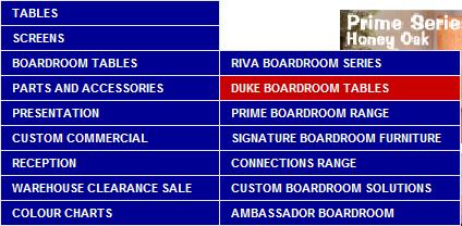

Hi DW Experts,
I'm new to DW8 and Fireworks CS3
Is it possible to create a menu from the left hand panel similar to the enclosed file? If yes, can you tell me how I create this in Dreamweaver 8 or Fireworks CS3 providing a detail instructions.?
Many thanks

Insert your cursor on the page where you want the menu.
Insert > Spry > Menu select "Vertical"
DW Help > Search: "Customize the Menu Bar widget"
In the results, click the item with the name above.
Follow the directions in the help file to customize the menu. Or would you like me to paste the contents of this help file into another post?

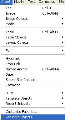

I cannot seems to locate this "Spry" from the Insert menu as shown from the enclosed file.
Dreamweaver 8 does not have the Spry wizards, nor will it ever.  You would need at least CS3 for that.  You can find a third party CSS menu easily enough or build an image based one from Insert | Image Objects | Navigation Bar

That's the whole point, I posted this QUESTION, I got only DW8 and Fireworks CS3, from these application I should be able to build this menu?
by: jason1178Posted on 2009-08-06 at 19:11:28ID: 25039576
"or build an image based one from Insert | Image Objects | Navigation Bar"
So, yes.

Hmm, apologies for the temporary break in transmission; DW versions got mixed up.
For DW8, use an extension: http://www.likno.com/wat_dreamweaver.html
