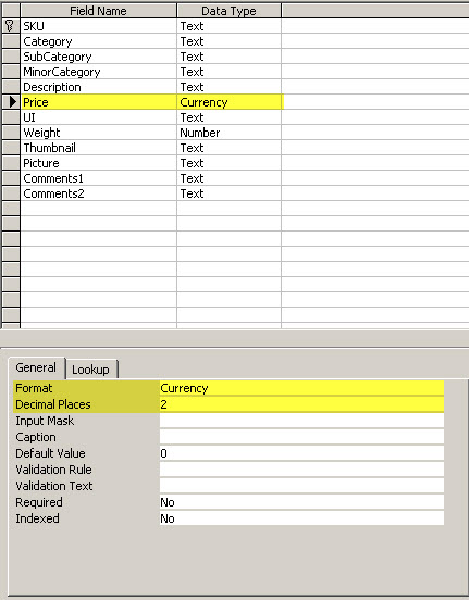

Thanks for the reply. I am getting the error currency mismatch on the page. On your screenshot I have a field above that with options like Double, Long Intreger etc.. I think this is where the problem is. Do you know which option it might be there?

Look at the table in design mode.  The field that you want to be currency should be Data Type Currency.  Currency data type should not have to have a precision declaration such as single, double, long, etc.  I do not have Access 2007 but checked both 2002 and 2003.  When I set the Data Type to Currency, the field "Field Size" (which is where the declaration single, double, long, etc appears) goes away.
Make sure that the Data Type for your currency field is "Currency", not number.  Then, when I call the field from the database, I use the following code:
Response.Write (FormatCurrency(rsProducts.Fields("Price"),2)

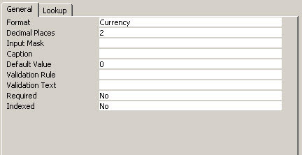

These are the Access database setting I use when storing currency. The important settings are highlighted.

Jim.... thanks a bunch. I was using 'Number' instead of currency which was messing me up. Appreciate you taking the time to assist.
