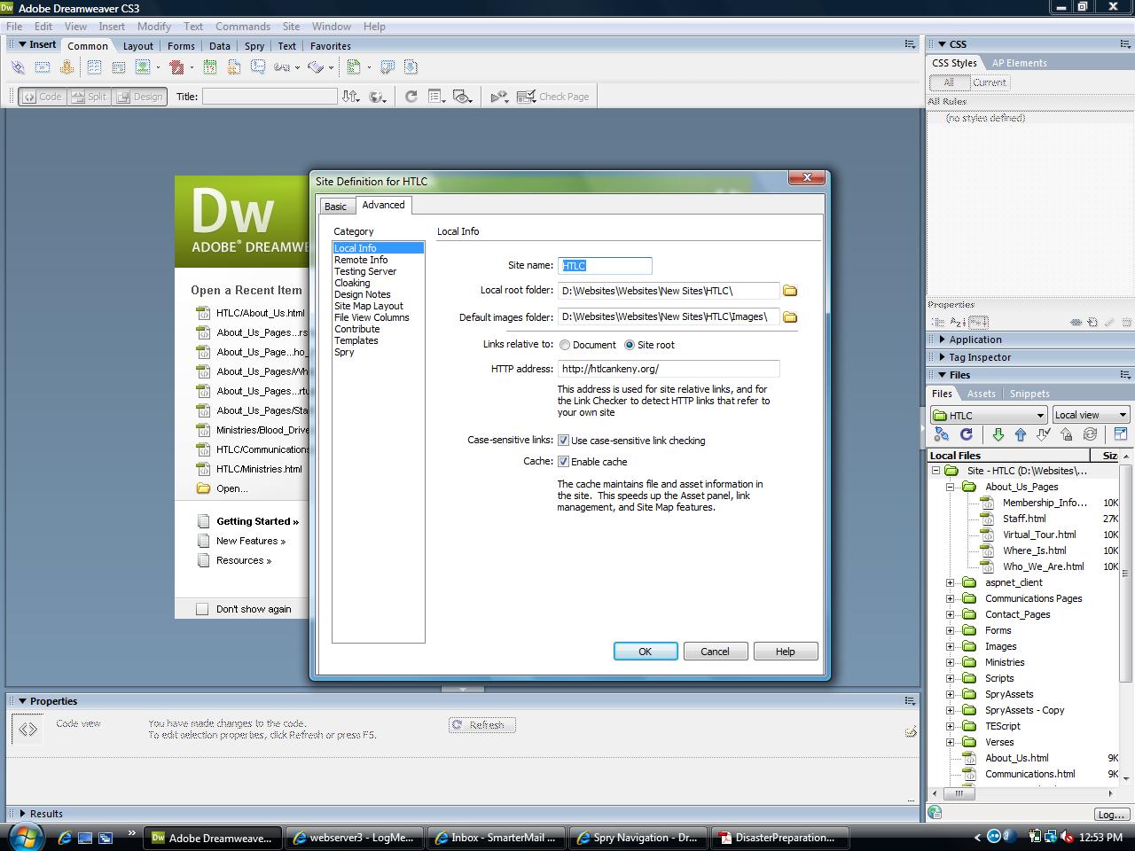

by: dsmjeffPosted on 2009-10-25 at 10:56:35ID: 25657455
I did upload yesterday, but didn't see any change, so  I started making other changes. I'll reupload again.
The way I'm changing the links in Dreamweaver,  I went to manage sites, then changed the links from page relative to root, but is there another way I need to do it?
I've always just left them at page relative. Is it better pratice to go to root relative?
I've uploaded a image.
by: jason1178Posted on 2009-10-25 at 17:10:11ID: 25659084
Changing it in the site definition only affects future documents.  You do need to go through each of your pages and change the links by hand to correct the problem.
