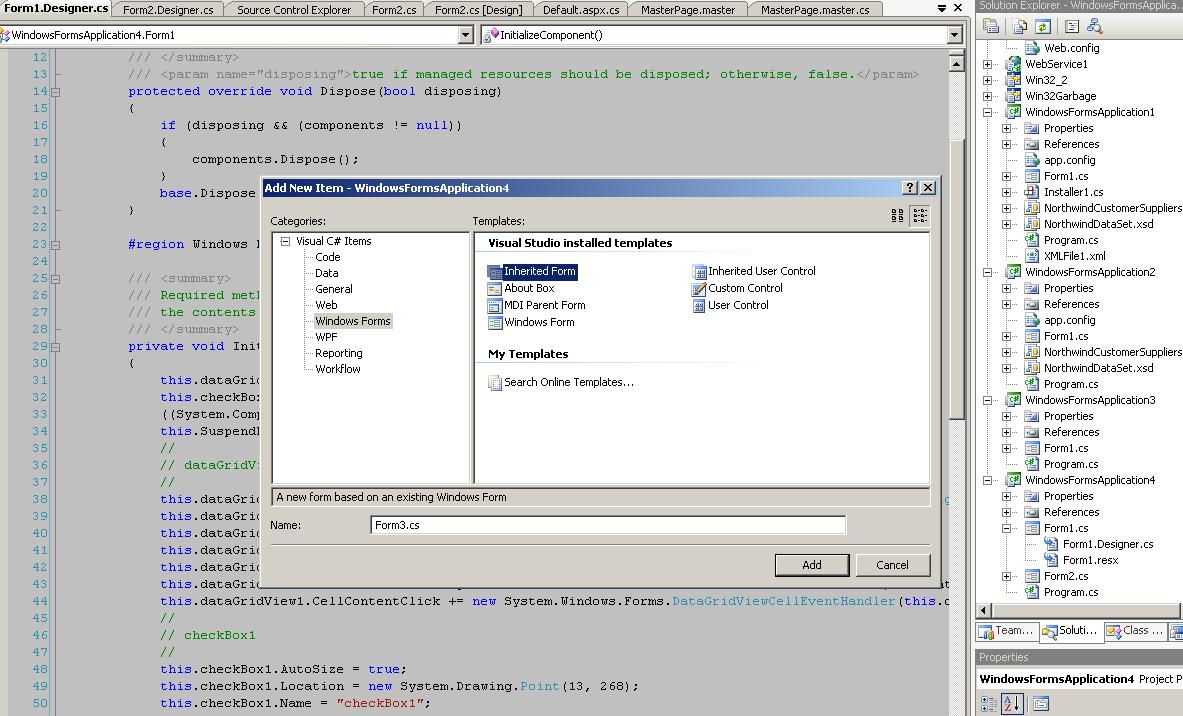

by: kaylanreilorPosted on 2009-09-22 at 23:09:55ID: 25400396
You can inherite your winforms from a base winforms.
Design the base form to provide the "master" layout, then use Project + Add New Item + Inherited Form
by: kaylanreilorPosted on 2009-09-22 at 23:13:49ID: 25400410
BTW, I'm not sure but I think this solution comes only with Visual Studio 2008. Perhaps it didn't exist yet with VS2005. So when you do Project + Add New Item + Inherited Form, Visual Studio displays the list of the already existing Forms in the selected project.

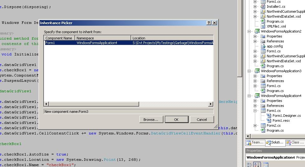

by: kaylanreilorPosted on 2009-09-23 at 00:01:41ID: 25400578
This is not a code. It is the menu in the solution explorer of visual studio !
by: kaylanreilorPosted on 2009-09-23 at 00:14:59ID: 25400631
So there is no specific code to write if you use Visual studio as the following screenshots show it.
On the other hand, if you want to do it manually , it is only an inheritance issue. So if your project is named MyProject and you designed a Winform named Form1, just create a Form2 Winform and change the definition into the Form2.cs to turn "public partial class Form2 : Form" into "public partial class Form2 : MyProject.Form1". And then delete evrything into the Form2.designer.cs to replace as following:
