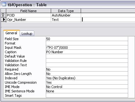

  I feel that my data store in my MsAccess table is only the part of 0000 and the other part PO 07/  is just used to display the data and while we retrieve the RecordSet from that table we had only 0000 part enstead of the whole one PO 07/2328.
The attachement is the fied property of my Access table.

You are correct.  The input mask is not actually saved to the field, only displayed to the user for input.  I don't know of any way to write a default input text that will store the "PO 07" text, unless you can do it on insert.  Maybe it can be done at the Access level with a VBA script.  But for now a simple write will do;
response.write "PO 07/" & (oRs("Opr_Number") &"<br>")
