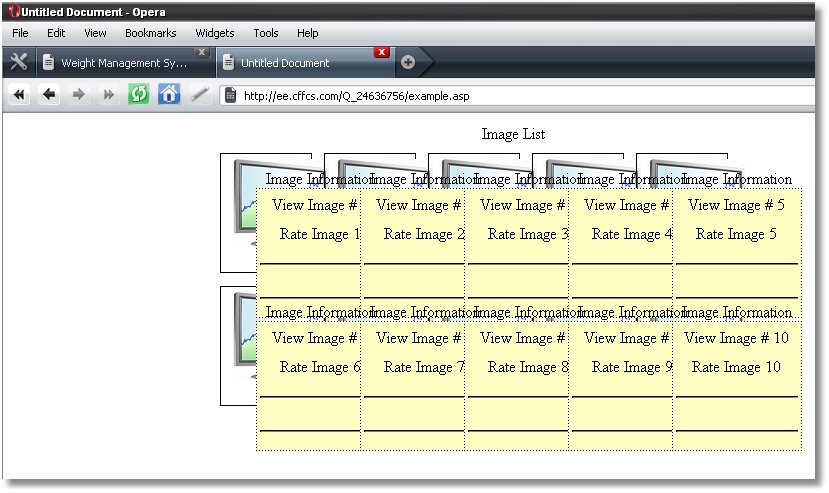

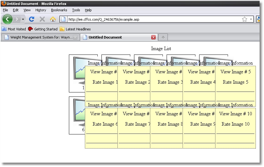

Now, in FF and Opera
The Div's are on top of all other div's on the page.

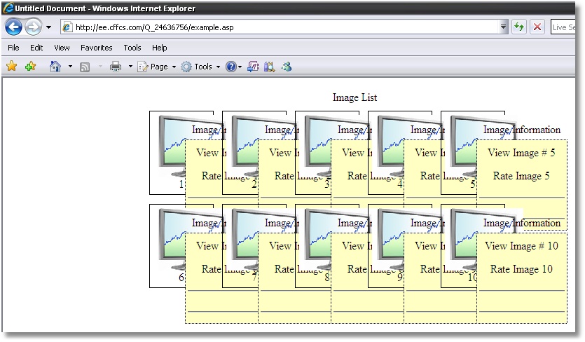

In IE6, 7, 8
The Div's are below all other Divs on the page.

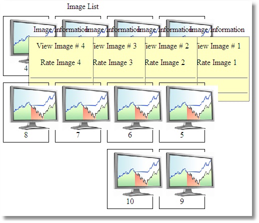

Now, if I set it to
float: right;
The Row you are on the Div's wil be on top, but the rows above and below
The divs will be on the bottom.
I have both demostrated in the images below. (The link and code are: Float:left; )
    • 81 KB
    This is with CSS - Float: Right (This is in IE, just showing the Top Row only, how it is on top of all others on the row, but on bottom of all Below it)
    • 138 KB
    The way it looks in IE6,7,8 (NOT!!! Suppose to be like this when all shown)
    • 135 KB
    The way it looks in Opera (Suppose to be like this when all shown)
    • 141 KB
    The way it looks in FF (Suppose to be like this when all shown)

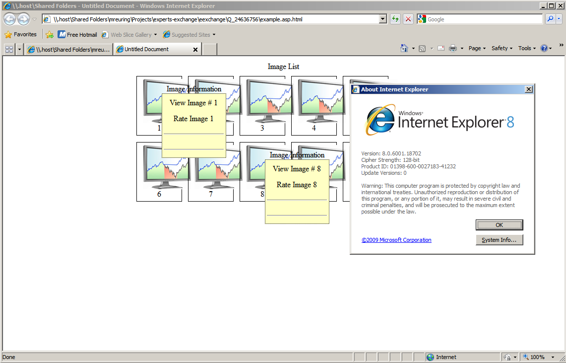

by: mreuringPosted on 2009-08-24 at 05:30:21ID: 25167606
I don't have a microsoft development environment, but once I fired up my VM and downloaded your archive and the latest version of your online test-page, it all looked just fine in IE8!
What windows version are you running? Or did you manage to solve the problem?
    • 116 KB
    http://ee.cffcs.com/Q_24636756/example.asp in IE8 / WinXP
