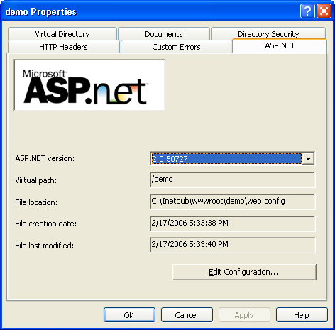

To enable ASP.NET 2.0 for an appication
Open IIS Manager, select your website, navigate to your virtual directory, right click on it and select properties, then choose the ASP.NET tab and in the version drop down select 2.0.50727

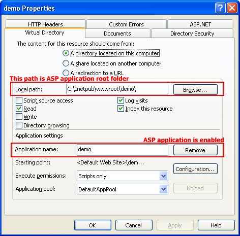

Open IIS Manager, select your website, navigate to your virtual directory, right click on it and select properties, then choose the Virtual Directory tab and click the create button next to the application name box. Apply, then OK.

Here is the Virtual Directory properties with the application name and button highlighted.
from
http://www.hkvstore.com/aspnetmaker/doc/aspnet2primer.htm

Herein lies the problem -- all of the screen shots above are for IIS 6.0 -- I am on IIS 5.0 [See screen shot below]. I have poked and prodded my way through IIS without success. There is no ASP.NET tab as we are all familiar with in IIS 6.0.
I thought maybe I needed to add some code to my web.config or something since there is no ASP.NET tab to use.
Jason
