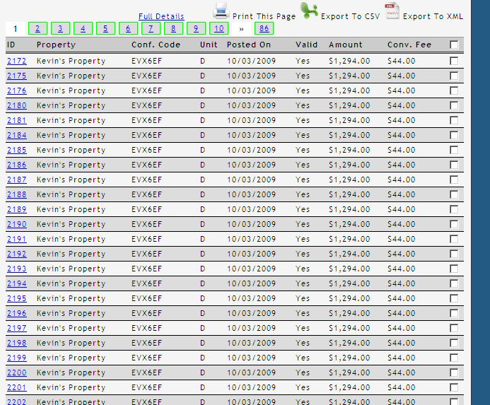

by: kevp75Posted on 2009-11-06 at 11:11:20ID: 25762112
umm...  actually...  it's more like yours, I just styled it a bit.  wrapped all the links in a span tag, and gave a class to the last page, first page, and current page
If I had a page not under login, i'd show you...  acually...   screenshot :)
by: carrzkissPosted on 2009-11-06 at 11:16:06ID: 25762159
Nice.
Looks sleek and very professional.
I might do something like that to mine, very neat.
Thank you for the image.
