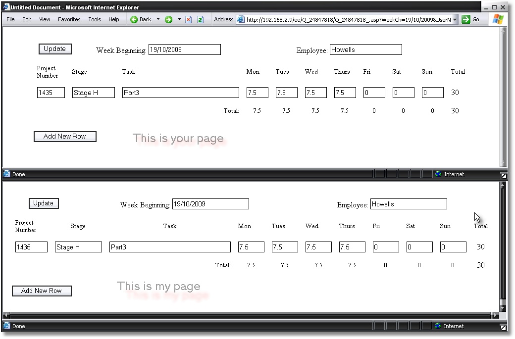

by: GegHPosted on 2009-10-29 at 13:31:41ID: 25697931
I have managed to get rid of the error but it still doesn't update the database or update on the page.
Any ideas?

by: GegHPosted on 2009-11-04 at 01:09:19ID: 25737553
carrzkiss,
Sorry, the intention was to put an A grade. It was getting late and i was getting confused about which question i was on. The intention wasn't to close this question. After i closed it i realised my error and was hoping you would still be monitoring it.
Attached is the full page.
The idea is to input the data and update the database as you go really.
First problem was to add a row at will then return to the same filtered, updated dataset to fill out the form.
As the week moves on you will add times to existing rows.
We have 50 employees and each employee should only be able to see their own timesheet, but choose the week they are filling in.
But that week date has to be generated at the start of the week.
For a novice this is incredibly complex, probably made more so when using Dreamweaver, that i guess throws up false errors every now and then.
<%@LANGUAGE="VBSCRIPT" CODEPAGE="1252"%>
<!--#include file="../Connections/Timesheet.asp" -->
' *** Edit Operations: declare variables
Dim MM_editAction
Dim MM_abortEdit
Dim MM_editQuery
Dim MM_editCmd
Dim MM_editConnection
Dim MM_editTable
Dim MM_editRedirectUrl
Dim MM_editColumn
Dim MM_recordId
Dim MM_fieldsStr
Dim MM_columnsStr
Dim MM_fields
Dim MM_columns
Dim MM_typeArray
Dim MM_formVal
Dim MM_delim
Dim MM_altVal
Dim MM_emptyVal
Dim MM_i
MM_editAction = CStr(Request.ServerVariables("SCRIPT_NAME"))
If (Request.QueryString <> "") Then
  MM_editAction = MM_editAction & "?" & Request.QueryString
End If
' boolean to abort record edit
MM_abortEdit = false
' query string to execute
MM_editQuery = ""
' *** Update Record: set variables
If (CStr(Request("MM_update")) = "TimeEd" And CStr(Request("MM_recordId")) <> "") Then
  MM_editConnection = MM_Timesheet_STRING
  MM_editTable = "tbl_TimeLog"
  MM_editColumn = "tID"
  MM_recordId = "" + Request.Form("MM_recordId") + ""
  MM_editRedirectUrl = "TimesheetEd3.asp"
  MM_fieldsStr  = "tProjNum|value|tStage|value|tTask|value|tMon|value|tTues|value|tWed|value|tThurs|value|tFri|value|tSat|value|tSun|value"
  MM_columnsStr = "tProjNum|',none,''|tStage|',none,''|tTask|',none,''|tMon|none,none,NULL|tTues|none,none,NULL|tWed|none,none,NULL|tThurs|none,none,NULL|tFri|none,none,NULL|tSat|none,none,NULL|tSun|none,none,NULL"
  ' create the MM_fields and MM_columns arrays
  MM_fields = Split(MM_fieldsStr, "|")
  MM_columns = Split(MM_columnsStr, "|")
  ' set the form values
  For MM_i = LBound(MM_fields) To UBound(MM_fields) Step 2
    MM_fields(MM_i+1) = CStr(Request.Form(MM_fields(MM_i)))
  Next
  ' append the query string to the redirect URL
  If (MM_editRedirectUrl <> "" And Request.QueryString <> "") Then
    If (InStr(1, MM_editRedirectUrl, "?", vbTextCompare) = 0 And Request.QueryString <> "") Then
      MM_editRedirectUrl = MM_editRedirectUrl & "?" & Request.QueryString
    Else
      MM_editRedirectUrl = MM_editRedirectUrl & "&" & Request.QueryString
    End If
  End If
End If
' *** Update Record: construct a sql update statement and execute it
If (CStr(Request("MM_update")) <> "" And CStr(Request("MM_recordId")) <> "") Then
  ' create the sql update statement
  MM_editQuery = "update " & MM_editTable & " set "
    MM_formVal = MM_fields(MM_i+1)
    MM_typeArray = Split(MM_columns(MM_i+1),",")
    MM_delim = MM_typeArray(0)
    If (MM_delim = "none") Then MM_delim = ""
    MM_altVal = MM_typeArray(1)
    If (MM_altVal = "none") Then MM_altVal = ""
    MM_emptyVal = MM_typeArray(2)
    If (MM_emptyVal = "none") Then MM_emptyVal = ""
    If (MM_formVal = "") Then
      MM_formVal = MM_emptyVal
    Else
      If (MM_altVal <> "") Then
        MM_formVal = MM_altVal
      ElseIf (MM_delim = "'") Then  ' escape quotes
        MM_formVal = "'" & Replace(MM_formVal,"'","''") & "'"
      Else
        MM_formVal = MM_delim + MM_formVal + MM_delim
      End If
    End If
    If (MM_i <> LBound(MM_fields)) Then
      MM_editQuery = MM_editQuery & ","
    End If
    MM_editQuery = MM_editQuery & MM_columns(MM_i) & " = " & MM_formVal
  Next
  MM_editQuery = MM_editQuery & " where " & MM_editColumn & " = " & MM_recordId
  If (Not MM_abortEdit) Then
    ' execute the update
    Set MM_editCmd = Server.CreateObject("ADODB.Command")
    MM_editCmd.ActiveConnection = MM_editConnection
    MM_editCmd.CommandText = MM_editQuery
    MM_editCmd.Execute
    MM_editCmd.ActiveConnection.Close
    If (MM_editRedirectUrl <> "") Then
      Response.Redirect(MM_editRedirectUrl)
    End If
  End If
End If

    <td> <% If Not rsTime.EOF Or Not rsTime.BOF Then %>
      <form action="<%=MM_editAction%>" method="POST" name="TimeEd" id="TimeEd">
        <div align="center">
          <table border="0" cellpadding="5" cellspacing="5">
            <tr>
              <td colspan="11"><table width="100%" border="0" cellspacing="0" cellpadding="3">
                  <tr>
                    <td><input name="Update" type="submit" id="Update" value="Update"></td>
                    <td>Week Beginning:
                      <input name="WeekCh" type="text" id="WeekCh" value="<%=(rsTime.Fields.Item("tWeekBegin").Value)%>" readonly="true">
                    </td>
                    <td>Employee:
                      <input name="UserNameCh" type="text" id="UserNameCh" value="<%=(rsTime.Fields.Item("tEmployeeNum").Value)%>">
                    </td>
                  </tr>
                </table></td>
            </tr>
            <tr>
              <td width="20"><font size="-1">Project Number</font></td>
              <td><font size="-1">Stage</font></td>
              <td><font size="-1">Task</font></td>
              <td width="10"><font size="-1">Mon</font></td>
              <td width="10"><font size="-1">Tues</font></td>
              <td width="10"><font size="-1">Wed</font></td>
              <td width="10"><font size="-1">Thurs</font></td>
              <td width="10"><font size="-1">Fri</font></td>
              <td width="10"><font size="-1">Sat</font></td>
              <td width="10"><font size="-1">Sun</font></td>
              <td><font size="-1">Total</font></td>
            </tr>
            <% While ((Repeat1__numRows <> 0) AND (NOT rsTime.EOF)) %>
            <tr>
              <td>
                <input name="tProjNum" type="text" id="tProjNum" value="<%=(rsTime.Fields.Item("tProjNum").Value)%>" size="5"></td>
              <td>
                <input name="tStage" type="text" id="tStage" value="<%=(rsTime.Fields.Item("tStage").Value)%>" size="10"></td>
              <td>
                <input name="tTask" type="text" id="tTask" value="<%=(rsTime.Fields.Item("tTask").Value)%>" size="35"></td>
              <td>
                <input name="tMon" type="text" id="tMon" value="<%=(rsTime.Fields.Item("tMon").Value)%>" size="3"></td>
              <td>
                <input name="tTues" type="text" id="tTues" value="<%=(rsTime.Fields.Item("tTues").Value)%>" size="3"></td>
              <td>
                <input name="tWed" type="text" id="tWed" value="<%=(rsTime.Fields.Item("tWed").Value)%>" size="3"></td>
              <td>
                <input name="tThurs" type="text" id="tThurs" value="<%=(rsTime.Fields.Item("tThurs").Value)%>" size="3"></td>
              <td>
                <input name="tFri" type="text" id="tFri" value="<%=(rsTime.Fields.Item("tFri").Value)%>" size="3"></td>
              <td>
                <input name="tSat" type="text" id="tSat" value="<%=(rsTime.Fields.Item("tSat").Value)%>" size="3"></td>
              <td>
                <input name="tSun" type="text" id="tSun" value="<%=(rsTime.Fields.Item("tSun").Value)%>" size="3"></td>
              <td>
	Dim MyNum
	Mynum = (rsTime.Fields.Item("tMon").Value)+(rsTime.Fields.Item("tTues").Value)+(rsTime.Fields.Item("tWed").Value)+(rsTime.Fields.Item("tThurs").Value)+(rsTime.Fields.Item("tFri").Value)+(rsTime.Fields.Item("tSat").Value)+(rsTime.Fields.Item("tSun").Value)
	Response.Write(Mynum)
	%> </td>
            </tr>
  Repeat1__index=Repeat1__index+1
  Repeat1__numRows=Repeat1__numRows-1
  rsTime.MoveNext()
Wend
            <tr>
              <td colspan="2"><p> <br>
                </p></td>
              <td><p align="right"><font size="-1">Total:</font></p></td>
              <td><p align="center"><font size="-1"><%=(rsTotal.Fields.Item("Expr1002").Value)%> </font></p></td>
              <td><p align="center"><font size="-1"><%=(rsTotal.Fields.Item("Expr1003").Value)%></font></p></td>
              <td><p align="center"><font size="-1"><%=(rsTotal.Fields.Item("Expr1004").Value)%></font></p></td>
              <td><p align="center"><font size="-1"><%=(rsTotal.Fields.Item("Expr1005").Value)%></font></p></td>
              <td><p align="center"><font size="-1"><%=(rsTotal.Fields.Item("Expr1006").Value)%></font></p></td>
              <td><p align="center"><font size="-1"><%=(rsTotal.Fields.Item("Expr1007").Value)%></font></p></td>
              <td><p align="center"><font size="-1"><%=(rsTotal.Fields.Item("Expr1008").Value)%></font></p></td>
              <td> <%
	Dim MyTotal
	MyTotal = (rsTotal.Fields.Item("Expr1002").Value)+(rsTotal.Fields.Item("Expr1003").Value)+(rsTotal.Fields.Item("Expr1004").Value)+(rsTotal.Fields.Item("Expr1005").Value)+(rsTotal.Fields.Item("Expr1006").Value)+(rsTotal.Fields.Item("Expr1007").Value)+(rsTotal.Fields.Item("Expr1008").Value)
	Response.Write(MyTotal)
	%> </td>
            </tr>
          </table>
          <% Do Until rsTime.EOF = True %>
          <input type="hidden" name="MM_update" value="TimeEd">
          <input type="hidden" name="MM_recordId" value="<%= rsTime.Fields.Item("tID").Value %>">
          <% Loop %>
        </div>
      </form>
      <% End If ' end Not rsTime.EOF Or NOT rsTime.BOF %>
        <tr>
          <td>
<form action="TimesheetInsert.asp" method="get" name="AddRow" id="AddRow">
              <input name="Submit" type="submit" id="Submit" value="Add New Row">
              <input name="WeekCh" type="hidden" id="WeekCh" value="<%=(rsPass.Fields.Item("tWeekBegin").Value)%>">
              <input name="UserNameCh" type="hidden" id="UserNameCh" value="<%=(rsLogin.Fields.Item("tEmployeeNum").Value)%>">

by: carrzkissPosted on 2009-11-04 at 03:52:35ID: 25738382
Due to the fact that you have an outside database "login"
I cannot test this script out to see what you are doing.
Your Database has so goodies in it, that trying to look at it
To determin what you are trying to do is going to be a nitemare.
I get passed 1 error and am faced with another Error.
And now your html coding is crashing my DWCS3.
Can you please put together a page that will run with the querystring of:
?WeekCh=26/10/2009&UserNameCh=1
Or whatever it is suppose to be.
I created a login table with the following fields:
tEmployeeNum
username
I know that the "tEmployeeNum" is correct, but that is all that I know.
Due to the fact that you are using * wildcards in place of your column names.
This is one reason why I am against the use of * wildcards being used in place of the column names, as it makes it so difficult to troubleshot someone else work when you do not have the proper database to go with the columns.
Give me a good working example, that does not have me "Having" to login
And I will see about helping you out on this project.
Right now, I am at a stand still.
Now, I have to figure out "why" your page is crashing DW for.
Carrzkiss
by: GegHPosted on 2009-11-04 at 06:04:15ID: 25739360
Carrzkiss
Attached is a database that has the login table inserted.
I've tested it this side and it seems to work. The page code attached is the one i use to get to the timesheet page.
Thankyou for all your help, i feel like i'm so close yet can't go any further.

by: carrzkissPosted on 2009-11-04 at 14:37:05ID: 25744825
In you form, you have the following
<form> here
</form>
  rsTime.MoveNext()
Wend
Why is this here for?
You only have a single form, but yet, you are trying to load multiple records.
Please explain this.
I have removed it as it is not needed.
ALSO.
What is this for:
          <% Loop %>
You are looping for no reason? (This also crashes in my design)
Please explain these 2 to me.
I am getting ready to design the Update statement now.
And will have it done within the hour.
Carrzkiss

I have the other user with multiple actions
WeekCh=26/10/2009&UserNameCh=Best
Are you wanting to allow the user to be able to update multiple
[Projects] at the same time? (There is more coding invlolved)
(or) (This is easier)
Have different <form>'s with their own [Submit] button for each [Project]
Which one do you want to do? I prefer the 2nd, as it is easier.
The 1st is more advance, and will take a little more time, and well.
[Experts Exchange] is not the place that I want to tackle it on.
Let me know?
by: GegHPosted on 2009-11-05 at 01:00:09ID: 25747700
The single submit button was really what i was looking for. The multiple submit buttons for each row/projects would do the job though.
I just worry that someone entering a time on a particular project will forget to press the submit button on that particular row.
Is there a way to set off a chain reaction, that pushing one submit button will run the 'submit' on each form on the page?
by: carrzkissPosted on 2009-11-05 at 04:47:50ID: 25748829
OK.
1 Button, submits multiple projects
http://ee.cffcs.com/Q_24847818/Q_24847818.asp?WeekCh=26/10/2009&UserNameCH=Best
code
http://ee.cffcs.com/Q_24847818/Q_24847818.zip
Please read the liner notes within the code.
This is NOT, I repeat: THIS IS NOT
Dreamweaver "DW" generated Code.
This is ASP/SQL Hand Coded.
Look through the code and understand it.
I have a few links within the code to information that I feel you should read
Up on in order to truely understand what the code will do for you.
Files included:
Q_24847818.asp => The entire project rest in this file, the forms and asp updates.
ADOVBS.inc => These are the Parameters used in the SQL.
TimeSheets.accdb => Your database
Q_24847818.zip => The zip archive which holds all files
I have also added in information about setting and using CSS properly.
I have also validated the entire page to XHTML Standard.
This should get your going in the right direction.
Carrzkiss
by: GegHPosted on 2009-11-05 at 06:22:19ID: 25749707
Absolutely awesome. Works perfectly.
