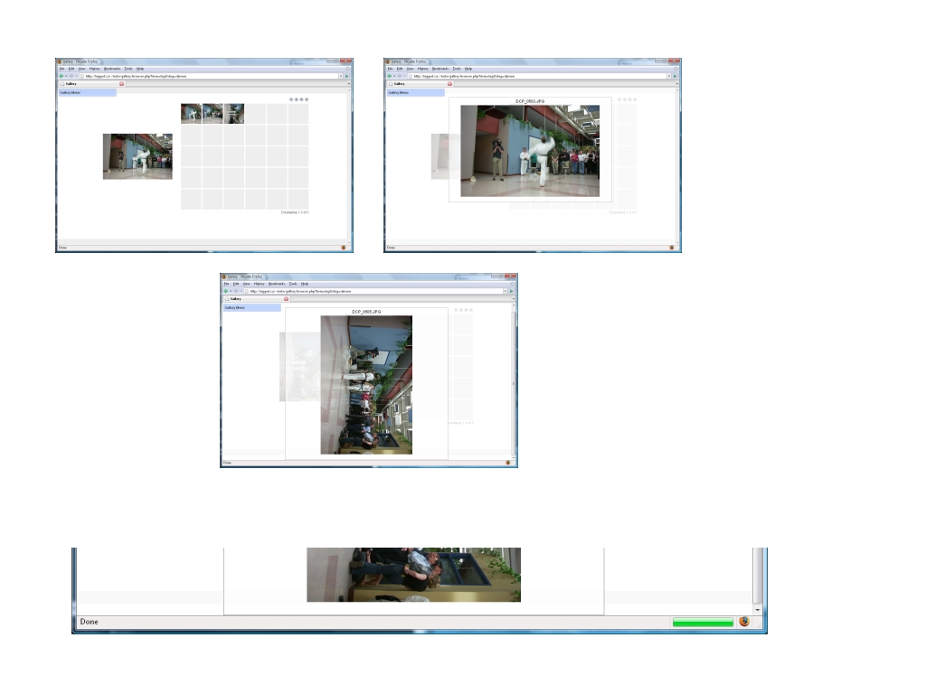

I am running into an issue with a DIV footer and dynamic page content.  I am using JS to display/hide an absolute positioned DIV box in the center of a page.  When this box is larger than the browser window, the scrollbar appears but the footer remains fixed in place.
I would like this footer to be glued to the browser window at all times and also have a margin-top of 10px.
Sorry for the poor example photo, my daughter just woke up and I had to hurry.  :P

by: ziffgonePosted on 2008-06-28 at 14:30:31ID: 21892093
If I understand your "glued" comment, try this:
#gallery_footer {
  background-color: #eee;
  height: 20px;
  border-top: 1px solid #ddd;
  position: fixed;
  bottom: 0px;
  margin:10px auto 0px auto;
  width: 100%;

by: ziffgonePosted on 2009-11-03 at 08:12:07ID: 25730414
Sorry mplungjan,
Unless I read this question wrong, his main objective is:
"I would like this footer to be glued to the browser window at all times and also have a margin-top of 10px."
Which can be done quite easily with CSS. Please see my example here:
http://ziffgone-enterprises.com/test/fixed_div.htm
This is what I was trying to portray in my solution above. Ultimately, it'd be nice to get Grly back here to decide. Might not happen though but I don't quite agree with scrathcyboy.

by: mplungjanPosted on 2009-11-05 at 05:00:48ID: 25748930
PS: Ziff: your example does not work in IE6 at all
by: mplungjanPosted on 2009-11-05 at 07:21:49ID: 25750392
this one DOES work however
http://www.cssstickyfooter.com/
