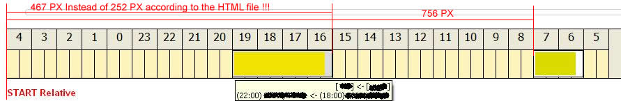

I put two divs (relative position) one with left:756px and the other with 252px.
for some reasons the browser draw the page  with the two divs with an error: the second div position is 467px relative instead of 252px!!!
what is the problem? how to fix it?
picture and code attached.

In the picture you've posted, the div does exactly what it's told to do:
It is sitting 252px to the left and 33px down of it's normal position. And it's normal position is *in the upper left corner of it's parent* (a table cell), which itself is positioned well off the viewport's left margin.
If you give this parent cell a border, e.g.  style="border:1px solid #f00;"  and set the div's left and top to different values between 0 and 252px/33px,  you will better understand what's happening.

tnx TName,
The div is sitting 252px to the left but I told it to sit 467px!

by: Forrest_GumpPosted on 2008-07-21 at 17:22:40ID: 22055574
Sorry!
I mistake you.
I need the div to be in position 252, but it position 467.
In the picture I attach I mark by mistake the right edge of the left div instead of it's left edge.
