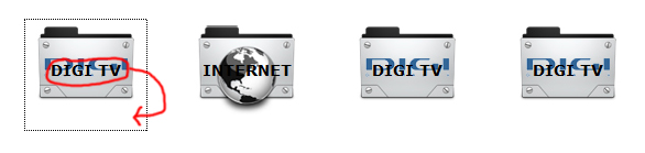

I have Unordered list and list items. in CSS, i cant move the text to the bottom, why?  only to half with line-height.....
I need to move text under the picture. If i give higher Line-height, the background picture is going down with the text..

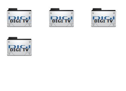

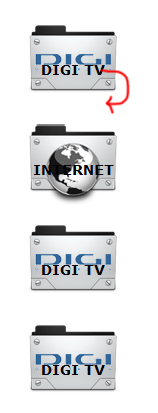

by: corthezzPosted on 2009-08-11 at 02:04:22ID: 25067174
Qwerty:
I need the text under the icon, with you solution i get all icons vertically..... i cant get text to the bottom
flob9, i tryed putting the span inside, same result...

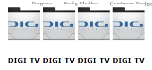

by: corthezzPosted on 2009-08-11 at 02:11:02ID: 25067203
if i put lineheight to 0, then the text is up. When i raise the nunmber, the text is going down, and stops in the middle.
