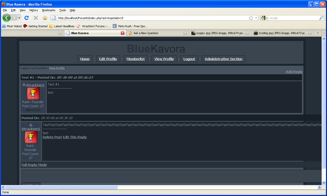

I am in the process of making a forum and whenever someone posts a message it will go over the table if it is a long enough. Now how do I fix this?
<td align="left" valign="top" class="forum_post" style="WORD-BREAK:BREAK-ALL;">
$message
</td></td></td>
</tr>
And it will exceed, how do I fix this?

I don't see a width for your td, so the table will expand as long as needed.
Does the table itself has a width set?
Does the table container has a width set?

1- set the width for your table td <td width=500 .....>
2- limit number of words on each line. you can do that using php... after certain number of words you can place line break <br />

You will need to set a width limit for the table container that can be accomplished with the below CSS table-layout property.  This will allow browsers to display your table faster.
I would also recommend placing a DIV inside your TD cells and set the overflow:auto; along with a height:XXpx; property on it.  I showed this with 200px as the value below as an example... This will create a scroll bar inside the div if the content exceeds the defined height dimension.

I agree with your scroll bar comment.  I am the same way.  I mistakenly assumed that based on the screen shot, the post "box" height was the same.
To prevent the scroll bars, then I would omit the height CSS declaration for the internal table cell.

I tried adding a width and it didn't work

Oh I didn't read your second one, sorry.
How would I exactly do that?
