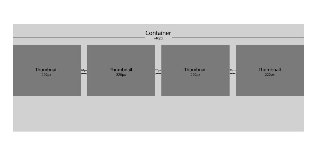

Hello!
This is a really big newbie question but I am trying to figure out something for a thumbnail gallery that's been bugging me.
Lets say I have a gallery that is contained within a div that has a specified width. I am trying to get the thumbnails evenly spaced out. Now, I know there are several ways to approach this. The method I usually use is to add margin-right to each thumbnail except for the thumbnail on the far right (I use a class that sets "margin-right" to 0).
However, this approach is getting a little annoying especially when I keep changing the thumbnails so the thumb on the far right is not always the same.
Can someone please let me know if there is a better way to approach this. I want to make sure that the thumbnails on the far right and the far left butt-up to the edge of the container.
Thanks!

by: KravimirPosted on 2009-10-13 at 10:36:05ID: 25562224
It sounds like they're left aligned. Have you considered centering them?

by: KravimirPosted on 2009-10-16 at 07:39:45ID: 25589970
Oh, right. I forgot you mentioned that detail. Try this:
<!DOCTYPE html PUBLIC "-//W3C//DTD HTML 4.01//EN"
   "http://www.w3.org/TR/html4/strict.dtd">
<html><head>
<meta http-equiv="Content-Type" content="text/html; charset=iso-8859-1">
<title></title>
<style type="text/css">/* <![CDATA[ */
div.container {
  width: 940px;
  background: #D1D1D1;
  padding: 20px 0;
  overflow: hidden; /* to contain the floats */
ul.thumnails {
  margin: 0 -10px;
  padding: 0;
  list-style-type: none;
  position: relative;
  width: 960px;
ul.thumnails li {
  width: 220px;
  float: left;
  margin: 0 10px;
  display: inline; /* IE6 fix */
  background: #7A7A7A;
/* ]]> */</style>
</head>
<body>
<div class="container">
<ul class="thumnails">
  <li>Thumbnail</li>
  <li>Thumbnail</li>
  <li>Thumbnail</li>
  <li>Thumbnail</li>
</ul>
</div>
</body>
</html>
by: qaljimmyPosted on 2009-10-16 at 07:52:22ID: 25590100
Even simpler approach
<style>
.container {list-style-type:none; margin:10px auto; padding:50px 0px; width:940px; background-color:#ccc; display:block; overflow:hidden;}
.container .thumb {list-style-type:none; padding:0px; margin:0px 20px 0px 0px; float:left; width:220px; height:150px; display:block; overflow:hidden; background-color:#999; }
.container .last {margin-right:0px;}
</style>
<ul class="container">
	<li class="thumb">Thumbnail</li>
	<li class="thumb last">Thumbnail</li>
</ul>
by: KravimirPosted on 2009-10-16 at 07:56:44ID: 25590147

by: furio13Posted on 2009-10-16 at 08:34:47ID: 25590502
Thanks again for the reply guys.
Kravimir:
I'm going to give your suggestion a try and I'll let you know how it goes.
qaljimmy:
I appreciate the help but as I mentioned in my question, I wanted to avoid using a different class for the far right thumbnail. I am using some Jquery to categorize my thumbnails so when someone selects a particular category, some of the thumbnails are removed from the list. Because of this, the far right thumbnail won't always be the same.
by: qaljimmyPosted on 2009-10-16 at 15:58:05ID: 25593949
In that case, using jQuery after you remove the thumbnails you don't want, you can also generate an additional class name for the last element in the thumbnail array/object. Thus able to use custom CSS property.
