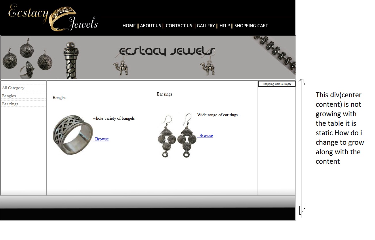

Css correction
Asked by: navinbabu
Hello .
http://www.ecstacyjewels.com/index.php
The div class of the center container is not growing according to the content Please help .
Also please suggest any corrections for a better UI

Im including the image below the center div is not growing .

by: DaymoHPosted on 2009-11-07 at 01:43:58ID: 25765611
Hi navinbabu
the div #layer2 has a specified height which will be restricting it. try using 100%
by: DaymoHPosted on 2009-11-07 at 01:50:26ID: 25765627
Also the background image is a fixed size so that won't resiz either. You need to make the lines at the bottom seperate and put them into a footer so that it will move up and down too.
by: sajayj2009Posted on 2009-11-07 at 03:48:38ID: 25765908
height:100% usually gives a wrong issue in some browser, better use - overflow:visible;
by: navinbabuPosted on 2009-11-07 at 04:51:02ID: 25766104
Hello ,
http://ecstacyjewels.com/cart.php
I removed the layer2 background image and also removed the hieght option it works for some pages
like http://ecstacyjewels.com/ and http://ecstacyjewels.com/aboutus.php and others again extra height is comming . How can i proceed ?
by: sajayj2009Posted on 2009-11-07 at 04:59:18ID: 25766137
extra <br /> "breaks" at bottom... :)
by: DaymoHPosted on 2009-11-07 at 05:48:47ID: 25766312
The extra height appears to be coming from the background div which has the height set at 768px you could now set that so it only shows the top bar, in other words about 140px.
by: navinbabuPosted on 2009-11-07 at 06:53:30ID: 25766508
