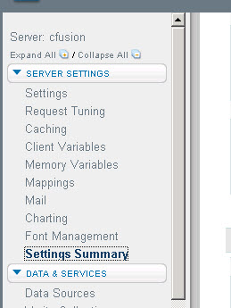

by: NYGiantsFanPosted on 2009-08-17 at 10:52:35ID: 25116643
Hmmmm. I don't see it..  See attached picture.
    • 25 KB
    picture of coldfusion administrator.. no jvm
by: erikTsomikPosted on 2009-08-17 at 10:53:29ID: 25116657
are  you an admin for the cf Administrator, if not contact the whoever has the admin priviliges
by: NYGiantsFanPosted on 2009-08-17 at 10:55:28ID: 25116678
I log into the coldfusion administrator using the administrator account?!?
by: NYGiantsFanPosted on 2009-08-17 at 11:26:34ID: 25116912
I have the highest level of privileges on that box.
