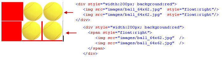

I notice that if I float:right two images they bump  up against each other nicely, but if I do it from a span there's a gap between the images, as shown in the attached image.  Does anyone know why span might be doing this?  There's nothing in my css file that affects the default behavior for span.

by: zatara1Posted on 2009-11-01 at 20:49:50ID: 25717118
Spans create a hard return in the HTML document and the images are trying to follow that, but the float is throwing it off.  I would try to change the span to a div and then make sure you clear: both to get the image to move down.

by: stevaPosted on 2009-11-01 at 21:09:21ID: 25717161
If I replace the span with a div, so that I have
<div style="width:200px; background:red">
  <div style="float:right">
     <img src="images/ball_64x62.jpg"  />
  </div>
</div>
I see the exact same thing as with the span, i.e., I get the gap between the floated images. So I guess it's not a span problem but a problem assigning float to a block.  Still, it seems that both these should work so my question now is why both a span and a div  put a gap between the floated images.
I'm not sure what you mean about the clear.  Where would you like me to put it?
by: stevaPosted on 2009-11-01 at 23:16:24ID: 25717510
I got it.
It's not the span that creates a hard return in the HTML it's the hard return between the first and second img tags. If I code
  <span style="float:right">
     <img src="images/ball_64x62.jpg"  /><img src="images/ball_64x62.jpg"  />
  </span>
</div>
the images butt up against each other perfectly. But if I even put a space between the two img tags, as below:
     <img src="images/ball_64x62.jpg"  /> <img src="images/ball_64x62.jpg"  />
  </span>
</div>
the gap is back.  And all of the above is true if I replace the span with div.  So the answer is, once you turn on float, it floats everything: the first image, the space or return, and then the second image.
