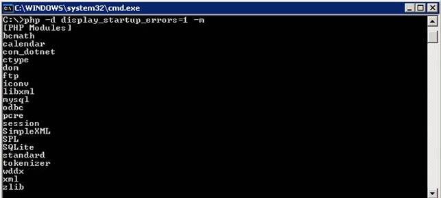

by: 4countyPosted on 2009-09-03 at 08:07:25ID: 25251446
I ran the command script and this is what it returned. ( I attached an image).
I didn't see any error's.
by: RQuadlingPosted on 2009-09-03 at 08:13:23ID: 25251507
Excellent.
Now run this from the command line ...
php -r "var_dump($conn=odbc_connect('DB','username','password'));"
changing DB, username and password to their appropriate values.
