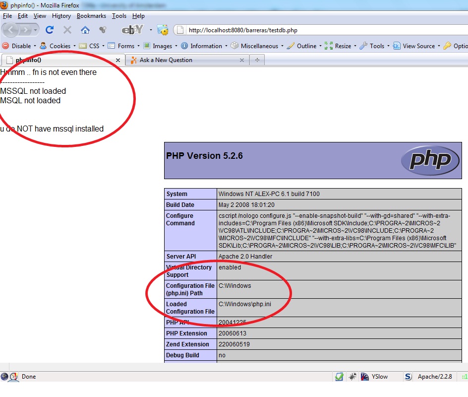

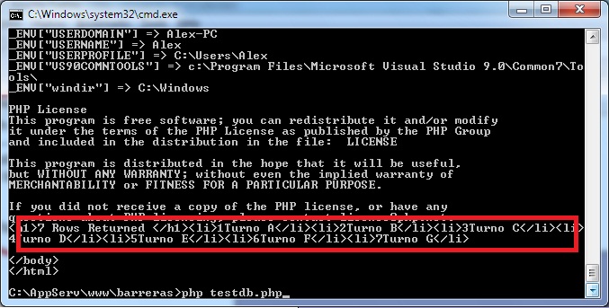

Hello all,
I've successfully setup AppServ on Windows 7 RC, enabled php_mssql extension, updated ntwdblib.dll, and wrote code to connect to an mssql database. If I run my code in a command prompt using php.exe, I'm able to connect to db and get results as seen on attached cmd-php.jpg image (the php.ini file loaded is on Appserv/php5 folder). But when I run the code from inside a browser, php_mssql extension is not loaded and I can't connect to the sql server as shown on attached browser.jpg image (the php.ini file loaded is on Windows folder). Both php.ini files are identically.
What should I try to get the code to work from inside the browser?
    • 102 KB
    successfully connect when running code using php.exe
    • 184 KB
    can't connect when running code from inside a browser

This is run on Windows, so extensions are .dll and not .so as in Linux. Also, I´m trying to connect to MS SQL Server and not MySQL, so the extension that need to be loaded is php_mssql.dll and not php_mysql.dll nor php_mysqli.dll.
I have TWO IDENTICAL php.ini files, one in c:\appserv\php5 and other in c:\windows. Both have enabled the php_mssql.dll extension.
When I run the testdb.php file from command prompt using php.exe, the php.ini in c:\appserv\php5 is loaded and mssql.dll´s are loaded also. But if I run testdb.php from inside a browser, the php.ini into c:\windows is used instead, and mssql.dll´s are not loaded.
I think the problem could be the link between PHP and Apache.
Any other suggestion, everyone?

by: alunaPosted on 2009-09-06 at 19:08:18ID: 25272406
Well, I've changed PHPIniDir in Apache configuration file to force it to use same php.ini as when running php.exe, that is, the php.ini located at c:\appserv\php5, so now I have onlye one php.ini file.
I've been looking at Apache logs and found errors when loading php_mssql.dll:
[Sun Sep 06 20:55:36 2009] [notice] Apache/2.2.8 (Win32) PHP/5.2.6 configured -- resuming normal operations
[Sun Sep 06 20:55:36 2009] [notice] Server built: Jan 18 2008 00:37:19
[Sun Sep 06 20:55:36 2009] [notice] Parent: Created child process 1608
PHP Warning:  PHP Startup: Unable to load dynamic library 'C:\\AppServ\\php5\\ext\\php_msql.dll' - The specified module could not be found.\r\n in Unknown on line 0
PHP Warning:  PHP Startup: Unable to load dynamic library 'C:\\AppServ\\php5\\ext\\php_mssql.dll' - The specified module could not be found.\r\n in Unknown on line 0
PHP Warning:  PHP Startup: Unable to load dynamic library 'C:\\AppServ\\php5\\ext\\php_pdo_mssql.dll' - The specified module could not be found.\r\n in Unknown on line 0
[Sun Sep 06 20:55:37 2009] [notice] Child 1608: Child process is running
[Sun Sep 06 20:55:37 2009] [notice] Child 1608: Acquired the start mutex.
[Sun Sep 06 20:55:37 2009] [notice] Child 1608: Starting 64 worker threads.
[Sun Sep 06 20:55:37 2009] [notice] Child 1608: Starting thread to listen on port 8080.
I don't know why Apache can't make PHP to load those libraries as they are in proper place and can be accessed (tried opening dll file contents from withing a web page and it showed up), also dlls for mysql are loaded and working properly.
Now this question turns into: Why Apache can't make PHP to load php_mssql.dll?

by: alunaPosted on 2009-09-06 at 20:25:44ID: 25272581
SOLVED!
Finally I solved this mystery.
The solution was set Apache service to start with administrator account instead of Local System account (this one was assigned upon AppServ installation).
Now php_mssql.dll gets loaded correctly and I can connect to SQL Server 2005 database.
