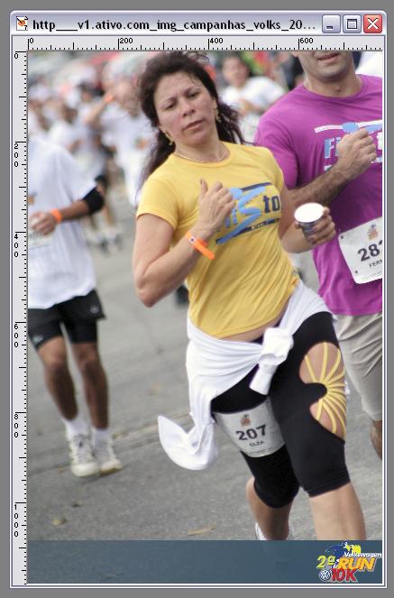

by: Ray_PaseurPosted on 2009-01-29 at 05:00:30ID: 23496688
Hmm... Interestingly EE's file uploader does not identify this as a JPG  (Possible File Type Mismatch).  Perhaps there is something about the file that is acceptable to Linux and Photoshop, but gives Windows a problem?  I clicked on the uploaded image in my post above and it came through fine.
What next?
by: vetrixicodePosted on 2009-01-29 at 12:13:26ID: 23501945
Hi Ray.
Both of your links worked, I've downloaded the image completely, BUT the image is not my image, it's a black BG with a red "INVALID IMAGE" text on it.
by: Ray_PaseurPosted on 2009-01-29 at 12:19:24ID: 23502044
It still works fine for me.  This time I saved it as a compressed JPG before uploading.
    • 47 KB
    Downloaded, saved and uploaded here.

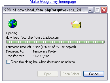

by: Ray_PaseurPosted on 2009-02-19 at 15:40:25ID: 23687420
Right, it was slow from ativo.  Here is a screen capture of the process.  It took about 8 seconds to start this box, then the progress bar shot across to the end, and it hung for a long time just like this.
