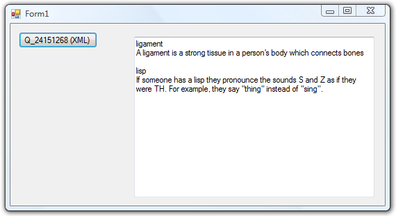

Here's the code for use in a VB form. In the screenshot you see the result. In the next message I'll put the XML that I eventually used.
The code you can put under a button, or wherever you like it. Place a TextBox on your form and name it TextBox1. Add a directory Data to your solution and put the XML (of the next comment) in it and call it Q_24151268.xml. Make sure to select "Copy Always" to make debugging and relative paths easier.
Dim xmlDoc As New XmlDocument()
xmlDoc.Load("Data/Q_24151268.xml")
Dim nodes As XmlNodeList = xmlDoc.SelectNodes("/dictionary/words/word")
For Each node As XmlNode In nodes
    TextBox1.Text &= node.Attributes("lemma").Value & vbCrLf
    TextBox1.Text &= node.FirstChild.Value.Trim() & vbCrLf & vbCrLf
Next

And finally, the result as it shows on a form, in the attached screenshot:
