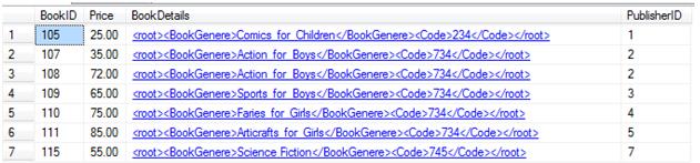

In Value method,  I tried the value method it gives error?
SELECT BookDetails.value('root/Code','integer') FROM Books
Msg 2389, Level 16, State 1, Line 1
XQuery [Books.BookDetails.value()]: 'value()' requires a singleton (or empty sequence), found operand of type 'xs:integer *'
My books Table looks like in attachment
This is how Books table was created
CREATE TABLE Books
BookID smallint IDENTITY(101,1),
Price smallmoney,
BookDetails XML (BookTypes))

@misermice: The value() method takes the data type from __SQL Server__ as a second argument. So instead of string you should use varchar/nvarchar (with the length specified in arenthesis) and instead of integer use int.
The error about singleton appears because the value() method expects a single node pointed by XPath given as the first argument of the method. So probably this one will work:
SELECT BookDetails.value('(/root/Code)[1]','integer') FROM Books
by: brejkPosted on 2009-09-14 at 06:52:59ID: 25325406
Ooop, I wanted to write:
SELECT BookDetails.value('(/root/Code)[1]','int') FROM Books
