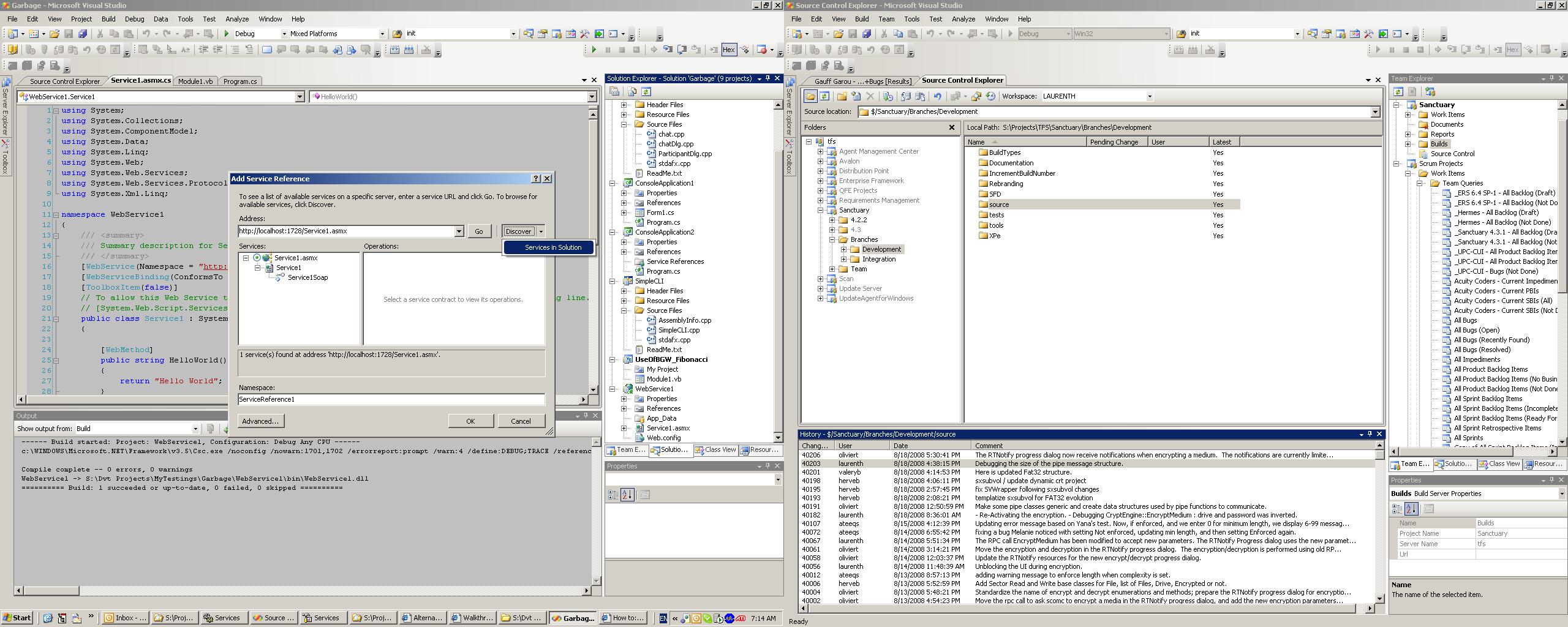

I'm trying to do the same kind of thing here, and the
ServiceReference1.ServiceClient sr = new ServiceReference1.ServiceClient();
doesn't work for me or make much sense.  Where does the "ServiceReference1 come from, and how did it get an "intellisensed" ServiceClient behind it, if it wasn't even instantiated yet?  Error occurs saying "The type or namespace name 'ServiceReference1' could not be found (are you missing a using directive or an assembly reference?)"
I have a web service I've referenced at http://localhost:4500/NewMsgSvc.  It has an event that will bring back message IDs if I give it a date to draw them back from, "GetEventsSince(DateTime since)".  All I wanna know is how do you call this interface for that web service I was given.  The web service has been referenced in my project.
