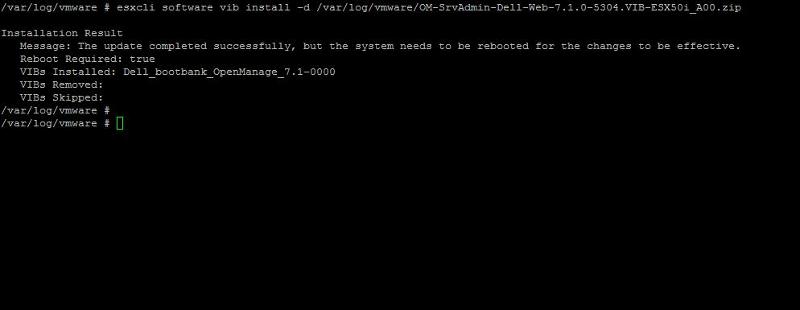

esxcli software vib install -d /var/log/vmware/OM-SrvAdmin-Dell-Web-7.1.0-5304.VIB-ESX50i_A00.zip
there is no output from the above command to suggest it's upgrading the firmware OS, but it should only take 2 minutes, and respond with the following screen. (I'm installing to a Dell Poweredge R710, ESXi 5.0 U1 installation is on a USB flash drive plugged in internally to the front slot).
Installation Result
VIBs installed successfully
Once the VIB has been successully applied, reboot the server using the reboot command at the console prompt.

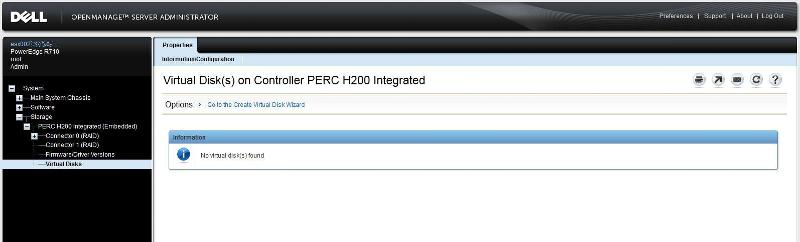

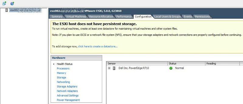

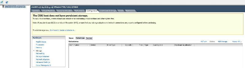

Storage Views from within the vSphere Client shows esx002, currently has no VMFS datastore defined.
Storage Views from within vSphere ClientStorage Views from within vSphere ClientExpand the Storage container on the right hand side under System.

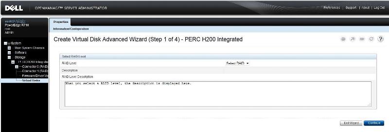

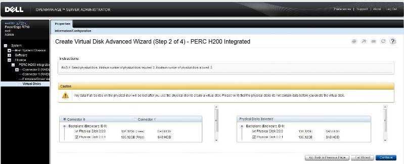

Expand the Storage container on the right hand side under SystemClick Virtual Disks, Click Go to the Create Virtual Disk Wizard.

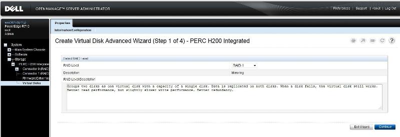

Based on your RAID requirements, select the RAID Level e.g. RAID-1 (Mirroring), followed by ContinueBased on your RAID requirements, select the RAID Level e.g. RAID-1 (Mirroring), followed by Continue

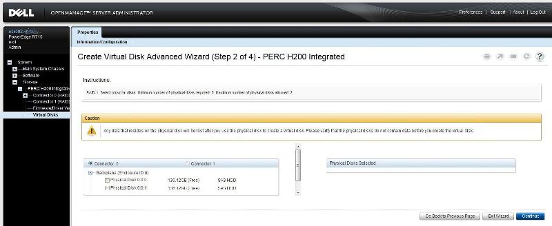

Select RAID typeSelect the Physical Disks required to be added to the virtual disk, followed by continue
Select Physical DisksPhysical Disk Selected for the Virtual Disk

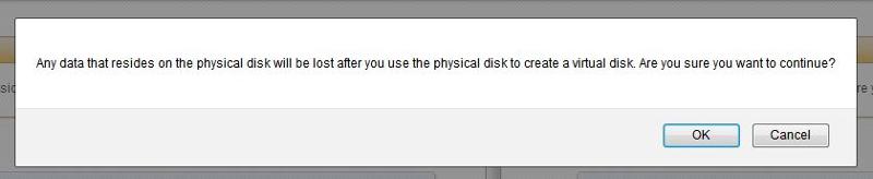

Disks SelectedSelect OK to the Any Data that resides on the physical disk will be lost after you use the physical disks to create a virtual disk. Are you sure you want to continue.

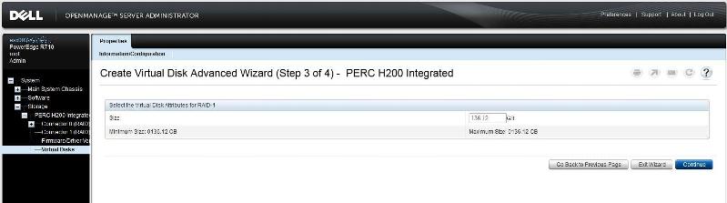

Select OK to erase dataCheck the size is correct, and Click continue

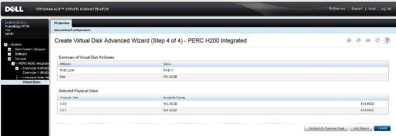

Check the size is correct, and Click continueCheck the Summary and Click Finish to Create the Virtual Disk.

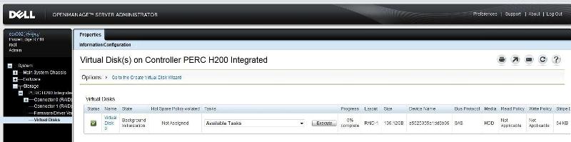

Remote Connections to ESXi can be rather sluggish, after a few minutes the display will show a Background Initialization state whilst the virtual disk is Initialized.
Background Initialization stateIt can take many minutes or hours for initialization to complete, once Background Initialization has completed the display will look similar to the following

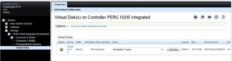

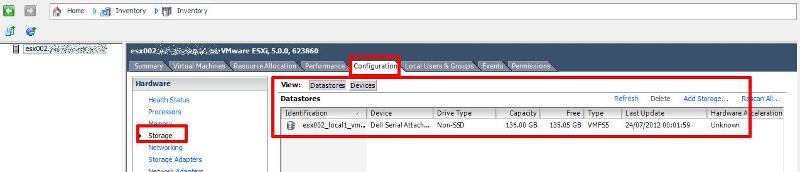

Background Initialization completedStorage View from within VMware vSphere Client
Storage View from the vSphere Client
You have successfully installed the Dell OpenManage System Administrator for ESXi, and then created a Virtual Disk, without restarting the server, which is a function that currently cannot be performed on a HP ProLiant Server!
