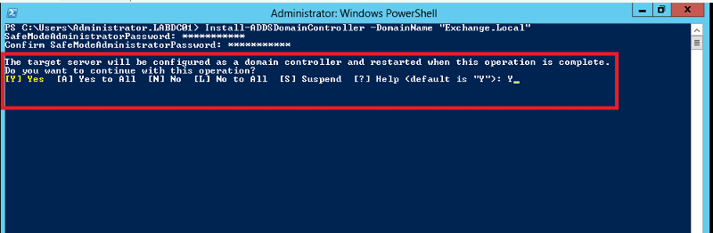

There are a few ways we can do this and I am going to show you the following method, which will install a domain controller into an existing domain and prompt for the Directory Services Restore Mode (DSRM) password.
In the same Powershell window, type > Install-ADDSDomainController -DomainName "<FQDN>" (where <FQDN> is a placeholder for you to input the fully qualified domain name of your domain e.g. exchange.local)
You will be prompted for the DSRM password
Type a complex password (recommended)
Press Enter
You will be asked to confirm the DSRM password, enter the password again
DSRM Password
Press Enter
You will be prompted to confirm you would like to continue promoting the server to a domain controller and that the domain controller will be restarted to complete the promotion if you go ahead, type > Y
Press Enter to begin
Confirm ActionsThis process can take an extended period of time to complete, the server will reboot upon completion, that's it you have now completed the process of installing a Windows Server 2012 domain controller using Powershell!
