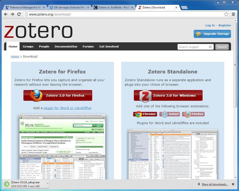

RM edit browser screenTo share a library using Zotero, follow these steps:
1.  Download Zotero and install if you have not already done so (this example uses the standalone version).
zotero downloadWhen/if you see a security warning click Run to start the install (windows 7)
