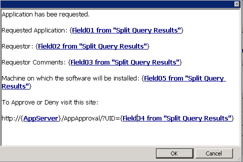

We would then create link filters where we would let the respective “leg” of the runbook run according to the result from true or false on the query, so if there was a request equal to or less than 2 min then the “First Mail” would be fired off sending a mail to the software asset manager detailing the request.
Mail Body would be as below

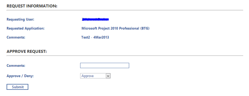

The Software asset manager will get the following example mail where a link will be provided to the ASP page so that he can approve or deny the request.
Where they would then be taken to the following page after clicking on the link

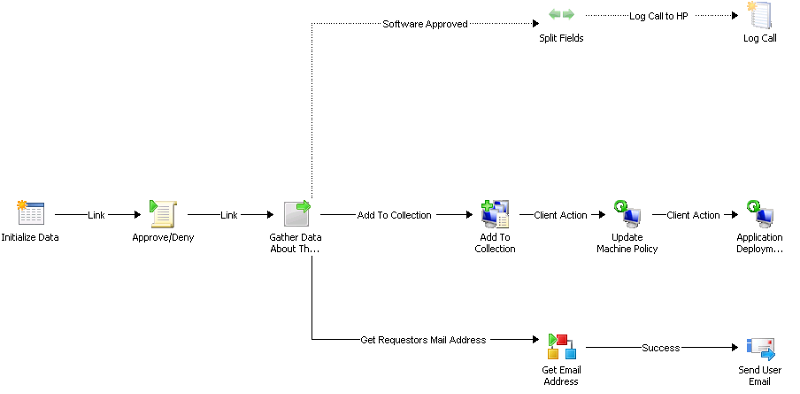

CM Approval Mail
This runbook would be doing the call logging, letting the user know if their request has been approved as well as adding the machine to the SCCM collection for install if approved.
Initialize data inputted from the ASP.Net page that was filled in by the SAM
You would then run the below activity that would run the PowerShell script to approve or deny the request & this entry would be taken from the “Initialize data”
I then gather data about the specific request to get the details of the user as well as the application.
If the request has been approved it will follow my link filters & automatically log a call in HPSM for the requesting user as well as add the user’s computer to the respective SCCM collection, update the machine policy as well as run an application eval cycle.
The Following Activity will add the requesting users machine to the SCCM collection that was collected from the "Gather Data about the request"
The "Update Machine Policy" client action activity will then be run to force the client to look for any new/updated policies.
Next the "Application Deployment Evaluation" client activity will be run so that the agent can get the notification that an application is ready to be installed.
This will then fire off the application install automatically & will start the setup of the requested application.
You will notice that in this runbook is the “Get Email Address” runbook invoke
This would run the next required runbook which would get the requesting users email address & then send them a mail letting them know if the SAM approved or denied their request & what the reason was.
Get Emails
This would get the username from the “Gather data about the request” & then split the domain field & then query AD for the user’s details returning the email address to the original runbook.
