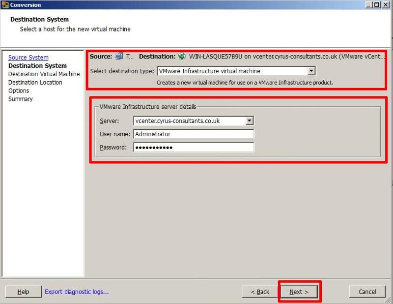

VMware vCenter Converter Standalone 5.1 - Specify vCenter ServerSelect destination type: VMware Infrastructure machine
Enter the destination server, username and password, in this example, I'm using our VMware vSphere vCenter server details, but if you wanted to synchronize/replicate to a standalone VMware vSphere Hypervisor (ESXi) host, you would enter the VMware vSphere Hypervisor (ESXi)  host details here, e.g. root username and password.

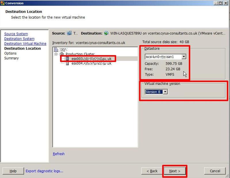

VMware vCenter Converter Standalone 5.1 - Specify Destination LocationSpecify the destination location for the machine followed by Next, if you are using a VMware vSphere vCenter Server and have a VMware Cluster created, you will have additional options to specify which VMware vSphere Hypervisor (ESXi) host to create the new virtual machine, also specify the datastore location. Ensure the virtual machine version matches the original VM, in this example v8.0.

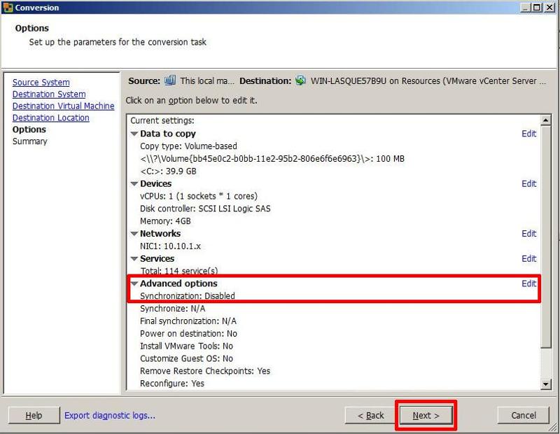

VMware vCenter Converter Standalone 5.1 - Enable SynchronizeIf you click Next at this point, the P2V (V2V) will complete as normal.
To enable the Synchronize function, you MUST select Edit
 VMware vCenter Converter Standalone 5.1 - Enable SynchroniseEnsure Synchronize changes is selected and ticked.
Ensure Perform final synchronization is Un-ticked.
If you wanted to perform, a Scheduled Synchronize, select and set the Schedule Option. Select Next to continue, review the Summary screen, and select Finish.

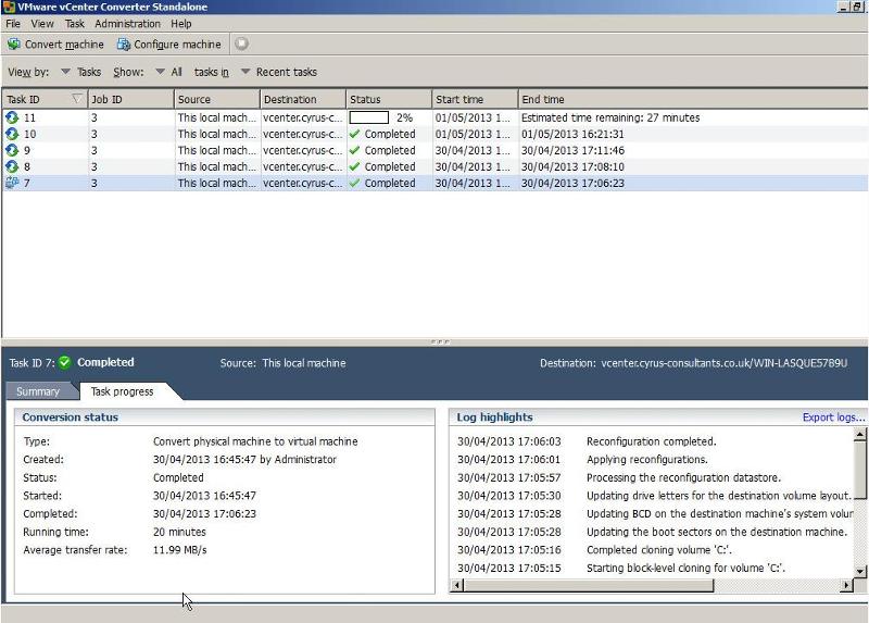

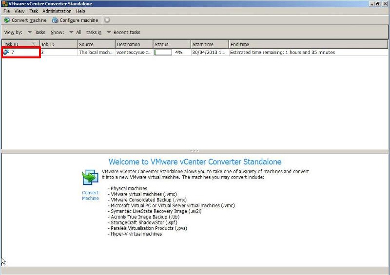

VMware vCenter Converter Standalone 5.1 - Summary ScreenA P2V job will be submitted and the P2V conversion will start.
VMware vCenter Converter Standalone 5.1 - P2V Job SubmittedIf you click the Task Id, you can check on the Task Progress.
VMware vCenter Converter Standalone 5.1 - Task ProgressIf you are finding conversions time are long, see my EE Article, on how to imporve transfer times.

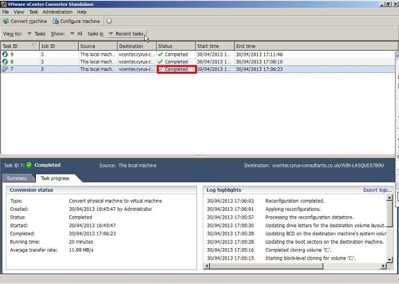

Once the initial P2V (V2V) conversion has completed, or "seeded" a new virtual machine, you can use the Synchronize function to replicate any changes that occur on the source machine to the virtual machine, the source machine could be a physical or virtual machine. (You can check the virtual machine by disconnecting networking, and powering up the virtual machine).

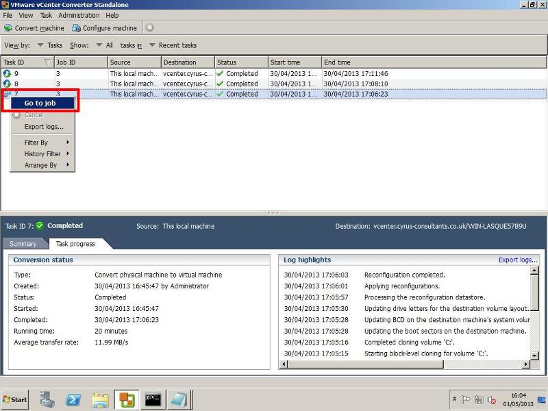

VMware vCenter Converter Standalone 5.1 - Job StatusThe Job Status should state Completed. Right Click the Task Id and select Go to job

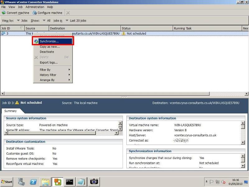

VMware vCenter Converter Standalone 5.1 - Go to JobYou will notice that the Status states Not Scheduled, this is because we did not set a schedule.
VMware vCenter Converter Standalone 5.1 - Not ScheduledRight Click the Job Id, and select Synchronize.

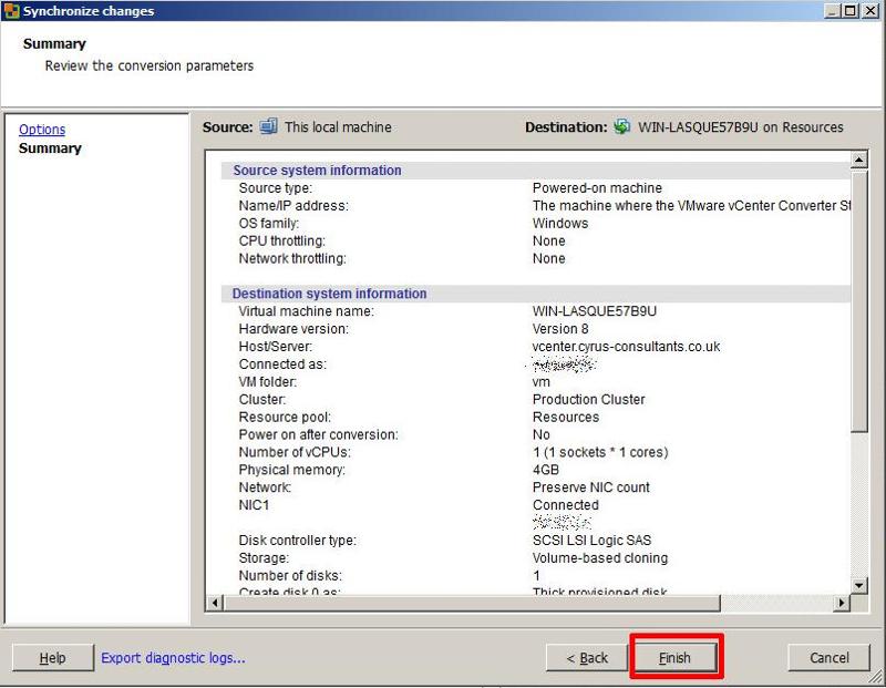

VMware vCenter Converter Standalone 5.1 - SynchronizeClick Next
VMware vCenter Converter Standalone 5.1 - Synchronize changesCheck the Summary page and Click Finish
