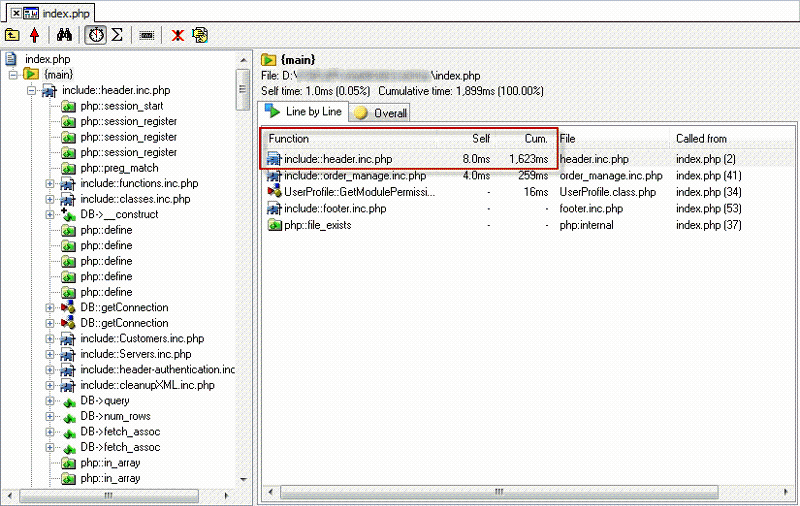

Here is a screenshot of a sample application with millions of lines of code that was profiled in a matter of seconds:
You'll see the treeview navigation on the left that allows me to drill down into any particular section of the code flow. I've selected the {main} section on that left side to see the top-level details of my script so I can see where the major bottlenecks are.
On the right side, I can see that while including the header.inc.php file only took 8 milliseconds, something inside the header.inc.php file took a whopping

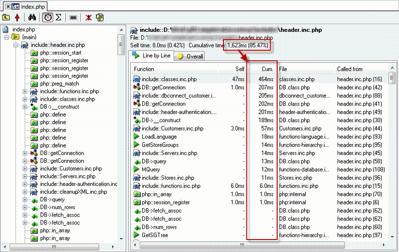

1.6 seconds to run! So if I navigate to the header.inc.php node on the left navigation pane, I can then see a breakdown of that time:
I can continue to drill down into each node if I want to keep getting further details about the performance, until I've learned exactly which line of code is responsible for the slowdowns. In the above examples, the slowdowns happen to be related to database connections.
