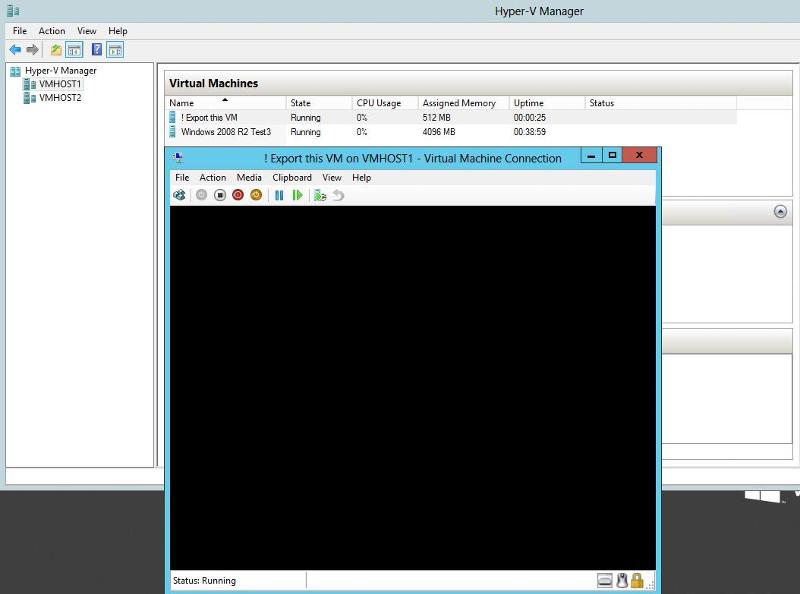

Start Hyper-V Manager on the serverOnce connected to the server, start Hyper-V Manager on the server. Hyper-V Manager

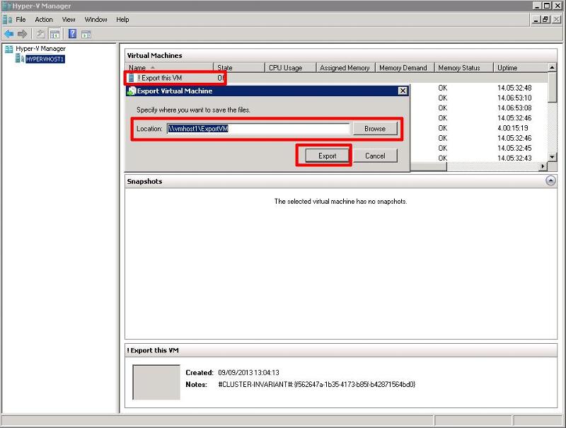

In Hyper-V manager, select the virtual machine to be migrated (exported), Right Click the virtual machine and select Export. If there is no Export option, check the virtual machine has been shutdown.
Specify where you want to save the Export virtual machine files. In this tutorial we have specified the server name and share to export the virtual machine files. vmhost1 is the server name of our Windows Server 2012 Hyper-V host, we want to migrate the guest virtual machine to, and ExportVM is the share we created in 3 above. Export VMClick Export to export the virtual machine. There is no progress indicator, the Cancel Exporting option disappears when the Task has been completed! A 50GB virtual machine took 6 minutes to export.

Logon or connect to the Windows Server 2012 R2 Hyper-V server which will host the migrated guest virtual machine. In this tutorial, we will connect to the Windows Server 2012 Hyper-V server using a Remote Desktop Connection via RDP (Remote Desktop Protocol). You could login via the console on the server, or execute the Hyper-V manager from your Administrator Workstation, with the correct permissions and connect to the Windows Server 2012 Hyper-V server, just ensure that your workstation has the sufficient network bandwidth to complete the migration (import) task. Remote Desktop ConnectionStart the Remote Desktop Connection applet on your workstation, and specify the servers name. The server we need to connect to, is the Windows Server 2012 Hyper-V server, which will be hosting our new migrated virtual machine. In this tutorial the server name is vmhost1. Hyper-V Manager 2012Once connected to the server, start Hyper-V Manager on the server. Hyper-V Manager 2012

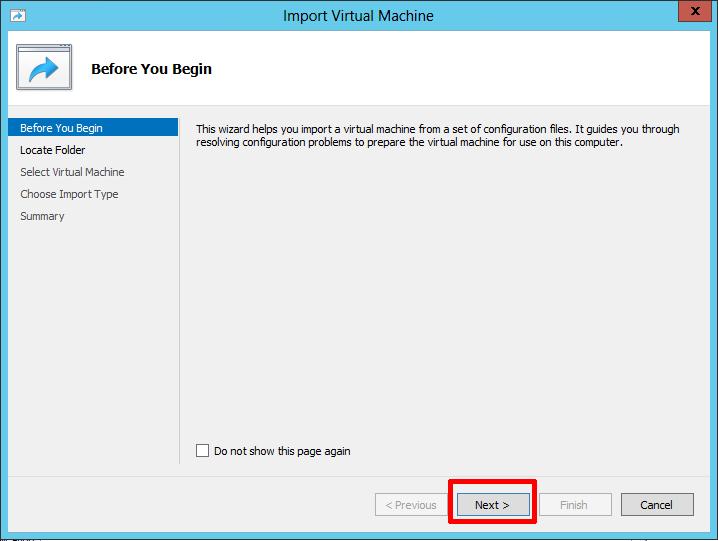

Select the host VMHOST1, Right Click the Host and select Import Virtual Machine...
Import Virtual Machine...At the Import Virtual Machine wizard, select Next to continue
