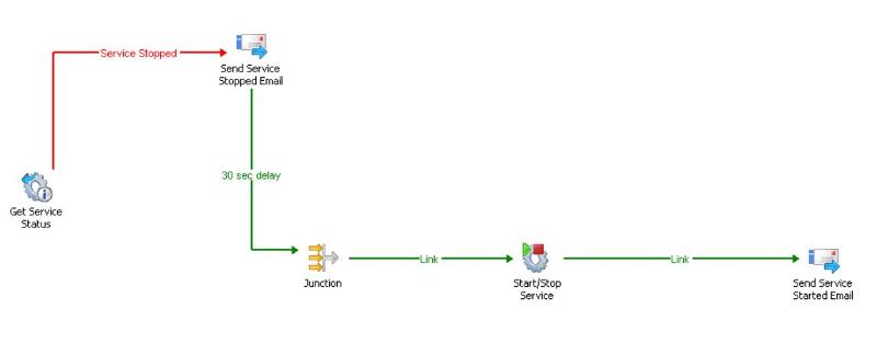

In the next example I have a windows service that is being monitored and instead of just having the alert or using the "Diagnostic and Recovery" to try remediate the service stopped error for me I use the "Diagnostic and Recovery" section in the monitor to trigger a specific Runbook using "SCOJobRunner"
![SCOM Monitor with SCOJobRunner Trigger]()
This monitor once an alert is raised will trigger the command and fire off my Runbook below.
![SCOM Triggered Runbook]()

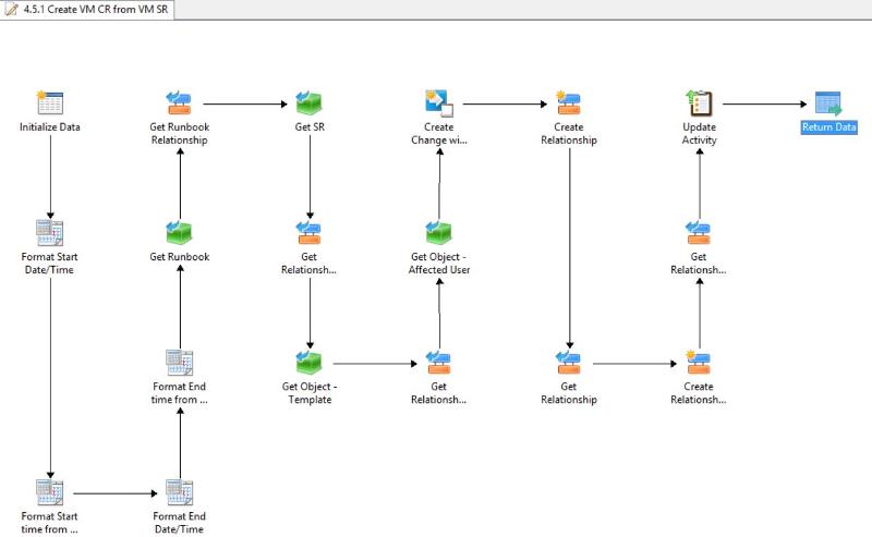

This Runbook then fries off the next Runbook which will get the "Service Request" format the date and time of my request because of SCSM saves your time in the UTC format and for Orchestrator to create the correct formats for our local time I had to do some editing and try add a few tricks so that my requestors could select the "Scheduled Start" and "Scheduled End" times so that even if approved the next Runbook which would be the one creating the VM would only be fired off if the Date and time is equal to or greater than the "Scheduled Start Date/Time"
I know, I know, seems like a whole lot of work, but trust me, it was worth it in the end and I almost fell off my chair with excitement when it all went through :)
Here are the rest of the Runbooks
![Create CR From SR]()
This is the Runbook that creates the Change Request from the Service Request and then sends the approvers a notification on the required approval.

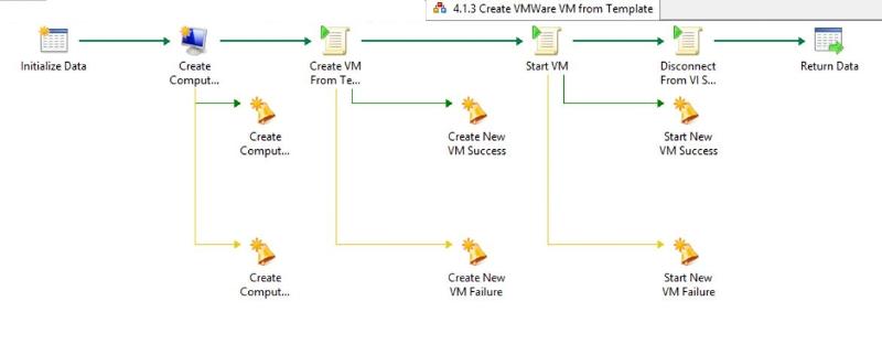

![Create VM From Template]()
This last Runbook actually creates the Computer account, Creates the VM, Starts the VM and as you will notice I have incorporated creating alerts in SCOM, for success (Information) and failure (Warning) so that it is also logged in SCOM.
