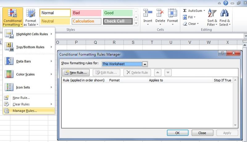

1. Menu:  Home --> Conditional Formatting --> Manage Rules
This opens the Conditional Formatting Rules Manager

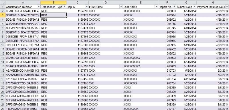

CF-Applies ToYou should now see every other row lightly colored.  These instructions only apply down to row 1000; you can easily edit that range and adjust as necessary.  (By the way, =MOD(ROW(),2) would also work, but it's less-obvious).
Alternating rowsIf you want to see some other alternating patterns, try these formulas:
Highlight every other pair of rows (2-white, 2-highlighted):  =MOD(ROW(),4)<2
Highlight every other group of four rows, just like good ol' greenbar:  =MOD(ROW(),8)<4
Highlight one out of every three rows (1-highlighted, 2-white): =MOD(ROW(),3)=0

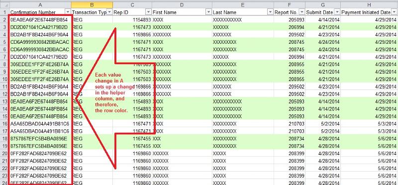

13. Change the value in the "Applies to" box to the following: =1:1000 (or as many rows as needed) then click the "OK" button.You should see a change in the row color for every change in your key column(s), like so:
value changeSome examples of where you might apply this kind of conditional formatting (in all cases, the data is sorted by the categories below):
