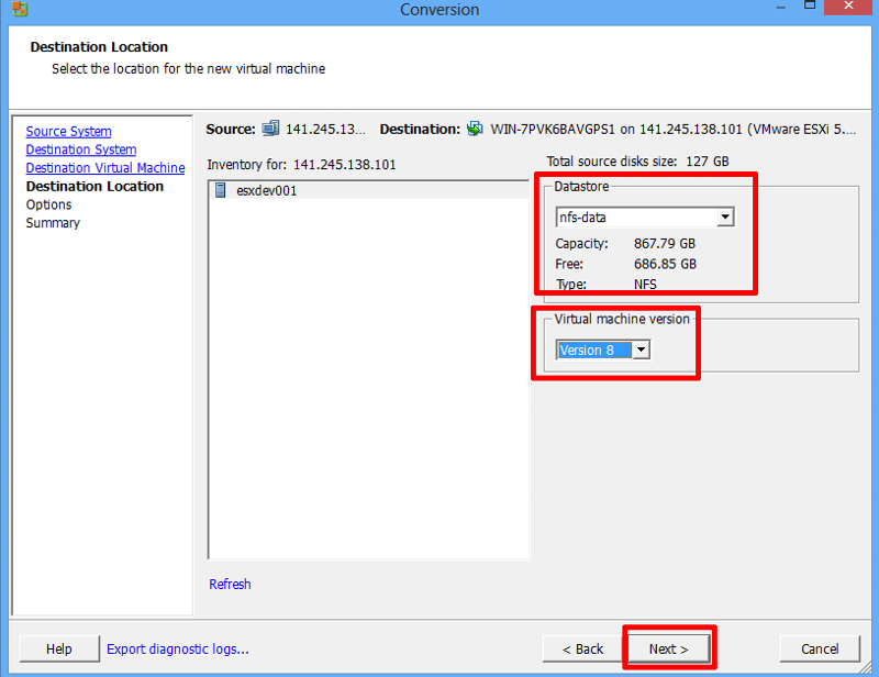

Select the Destination Location for the virtual machine, select a valid datastore with enough storage space,
destination-system3.pngand select a Virtual machine version (Beware version 10 and later can ONLY be managed using the vSphere Web Client available with vCenter Server).
VMware products and their virtual hardware version:
For further details see here VMware KB: Virtual machine hardware versions
We often select Virtual machine version 8 for ESXi 5.x, and I would recommend this virtual machine version unless you have a specific requirement for 9 or 10.
Click Next to Continue
