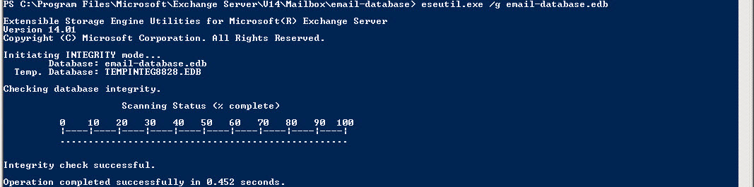

/G Integrity: Page and ESE level integrity can be checked using this switch. For application level, the Isinteg utility has to be used.
Integrity of database can be checked out using “eseutil /g ” parameter

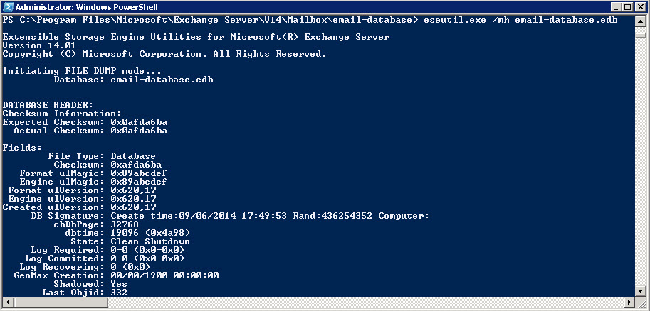

/M File Dump: Details about the database, its header, transaction logs, checkpoint files, database space allocation etc. can be checked with this switch. The file dump mode of Eseutil can be run with following modes:
/mh: View Header information of the EDB file.
