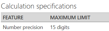

You will notice this standard in many ways in Excel, but the main is, that if you write an integer with more than 15 digits (which is quite feasible), excel will transform all integers starting with the 16th to zero. So when you put 1234567890123456789 in a cell, you get 1234567890123450000. The same goes for 1234567890.123456789 that would give 1234567890.123450000! This is by itself quite a drawback, but it doesn’t end there, this limitation impacts all parts of Excel, including calculations. Below is a very simple calculation…

The short answer is NO since Excel works as it was built to work. The long answer is, you can store longer number as text (so begin writing in Excel with an apostrophe), and you will see more than 15 integers, but if you will want to convert them back to numbers and do calculations with them, you will again only work with 15 integers!
