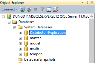

Distributor4.PNG6- Add current server as Publisher
7- Finish
Distributor5.PNGNow, you can see Distribution Database in the System Databases folder
