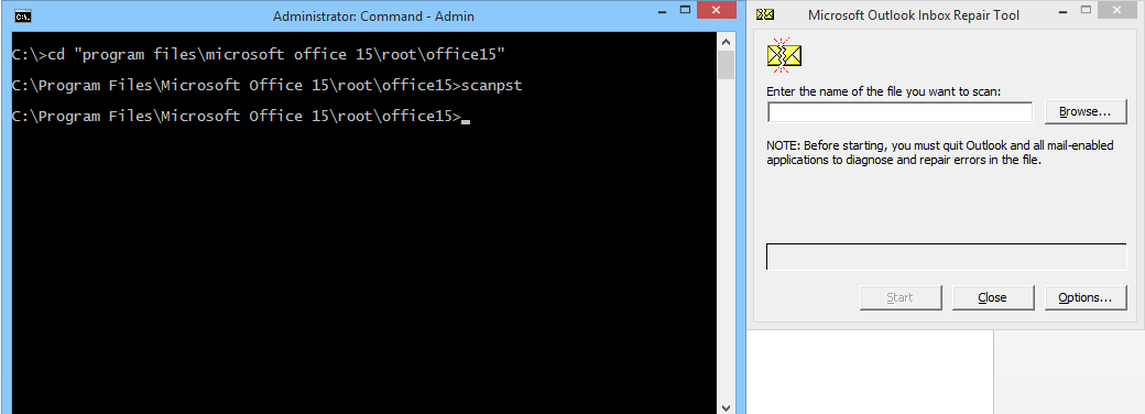

Outlook cannot start, or the mail file does work properly (Data file damage)
In this document, we assumed you have a local PST file and if Outlook cannot start the file or if it has issues has once the file is loaded, the PST file may need to be rebuilt and corrected. You can check and rebuild the Outlook PST file with SCANPST.EXE.
Find out where your Outlook data file (PST file) is stored. If you can open Outlook, go to File, Account Settings and use the Data tab to show you where the data files are located. Normally the files are in: C:\Users\username\Document
s\Outlook Files
Make a copy of Outlook.pst in a non-Outlook (non-Users) location, say, C:\Temp.
Find the location of SCANPST.EXE. Normally it is here: C:\Program Files\Microsoft Office 15\root\office15\scanpst.e
xe
Now open cmd.exe with Run as Administrator. Navigate to C:\Program Files\Microsoft Office 15\root\office15 and run SCANPST. See the screen shot below for to assist you.
![Scanpst-Progam.png]()
Now browse to C:\Users\username\Document
s\ and open Outlook.PST. The repair will run and 95 times out of 100, it will repair successfully. If not, you need to look for commercial repair tools. Stellar Outlook PST Recovery Software is such commercial software. At the time I wrote this article, Stellar Recovery Software is available at:
http://www.stellarinfo.com/outlook-pst-file-recovery.htm
If the repair was successful, now see if Outlook starts and behaves normally.
