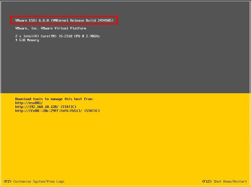

5. Check that the ESXi 5.5 Host server has been upgraded
  • Check the following:
    • The Console Screen should report VMware ESXi 6.0.0 (VMKernel Release Build 2494585)
Congratulations, you have successfully upgraded your host server from VMware ESXi 5.5to VMware ESXi 6.0.
