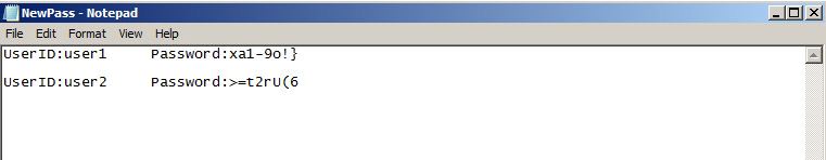

  Now we just need to test the Script, open your PowerShell and write the name of your PowerShell file followed by [ENTER], in my case is Random.ps1 and wait until the execution finished. This could take some time, depends of the number of users inside the Organizational Unit (OU).
PS1.JPGIf everything went well, no message is displayed, now you need to open txt file generated by the script and check the usernames and new passwords for the users.
Please note that in my case the defined path to save my files is defined on the beginning of my script like this
[String]$path= ".\NewPass.txt".
