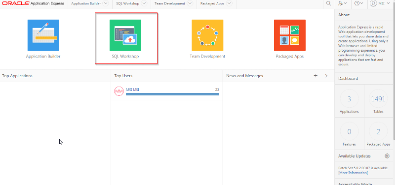

  • Login to your APEX application:

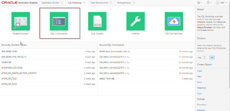

1.pngClick on "SQL Workshop" as shown in above screen shot.
2.pngNow you can see under "SQL workshop" we have an option to select "SQL Commands" . This is the place where we can select and write any SQL statements or any PLSQL code to execute and check the output. Once you select the option as shown in above screen shot we will see the below screen which is called as "SQL Command Tool".

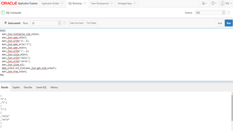

The below screen shot shows an example like how we can execute SQL and PLSQL statements on the top sections and see the result in the bottom sections.

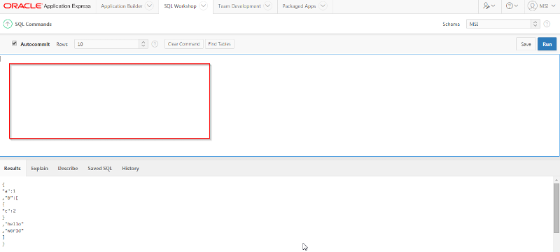

SQL-Tool.pngIn the top section of the SQL commands tool we can see there is button called "Clear Command" , to clear the screen of the top section this option is used. Form the above screen shot we can see that we have executed on PLSQL block now let us see what will happen when we click on the  "Clear Command" button.
4.pngFrom the above screen we can see that only the top section is cleared where we have written our PLSLQ code to execute but the result remains the same unless the next SQL or PLSQL statements are executed.

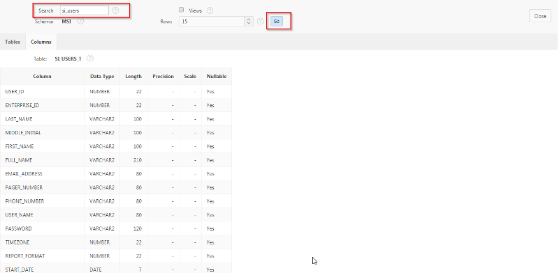

We also see another button beside that called " Find Tables" , once clicked on it we will see another window which helps us to search any table name from our database and check the details of the columns and its types.
I selected the table name called "SI_USERS_T" .

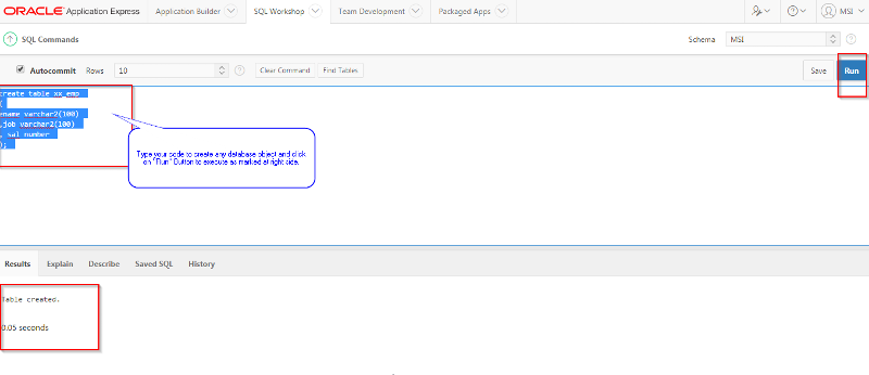

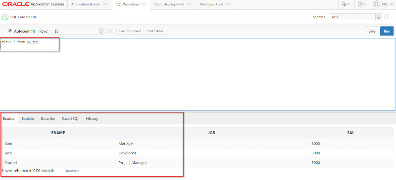

7.pngWe can create an database object using SQL command tool for example let us create a simple table called "XX_EMP" :
8.pngFrom the above screen shot we can see that we have created the table successfully and now let us write one PLSQL block to insert few records.
9.pngNow let us query the table and see the result.

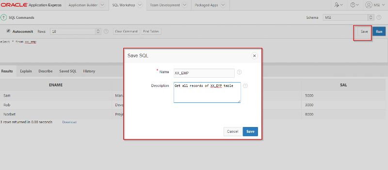

11.pngThis tool also allows us to save any queries using the save option on top section beside "Run" button.  Once we click on "SAVE" we will get the window to give a name and provide some description as shown in below screen.

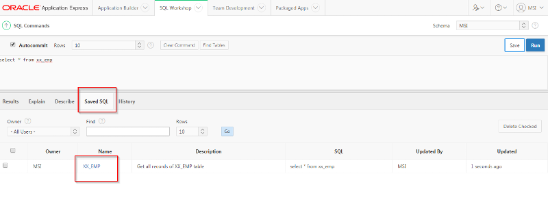

12.pngOnce you filled the information then click on SAVE as shown in the above screen shot.  Now if we want to see what the SQL that are been saved , we can check under "Saved SQL" under the bottom section of the SQL command tool .
