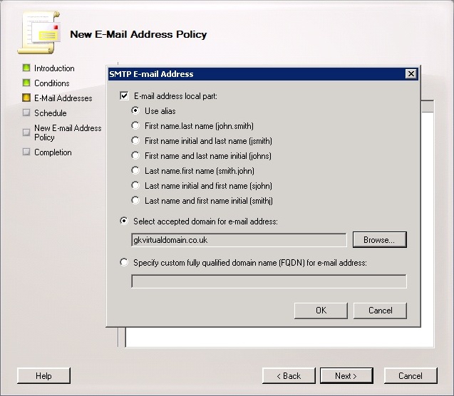

  email_policy_03On the E-Mail Addresses screen you need to define what e-mail address will be used by this domain.  Select one of the default settings (if there is not one in the list that matches your requirements we can modify it later) then click the Browse button to select the domain you created earlier as an accepted domain.   NOTE if the domain isn’t listed then Exchange does not see it as an accepted domain.  Once you have selected the domain click OK.  Once back at the main wizard right click on the e-mail address it will allow you to edit the format of the address allowing you to define your own local part of the address.  The fields you require can be found here: http://support.microsoft.com/kb/285136

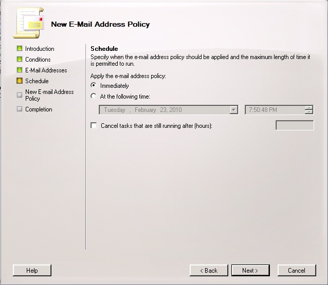

  email_policy_04On the Schedule screen, select when you would like the schedule to run.  This process does not stop any services but if you have a large amount of users it could take some time to apply and may cause a slight degradation of service.  Click Next.
